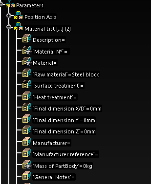

I have a drawing with several parameters created. Now I want to to create text notes in drawing linked to those parameters. I haven't found how to do it.
Any idea?

I'm creating the macro to generate the title block and frame of my company. After all of this time working with CATIA, I never had much the need of doing 2D drawing. every time that I need to make some drawings I used a few templates that I have stored, and fill it by and. Now I'm doing something that I really need to make lots of drawings, then I need to do it properly, otherwise I will die fill the title blocks....
So what I have:
In the CATPart file I have a few parameters, that can be used in BOM and in title block of drawing.
In the CATDrawing, i create the need parameters to fill the title block
Now when I insert the title block of my company, I want that draws the entire frame and title block, and when creates the several texts of title block. I will also create a copy and past as a result with link, the desired parameters from the CATPart, after I want to create the attribute link to the parameter. Like this I want to have a link between the parameter and title block. If I change a parameter in the catpart the title block will update (at least it's what i'm expecting)
Please note: I create my drawing template like this, but I don't know if there is an easier way to do it. When I worked with solidworks in the past, I remember that when we insert the part file in the drawing, the drawing recognize all of parameters of the part, In CATIA i Haven't found how to do it.

It seems a little bit complicated....
You can avoid creating parameters in drawing, you can read the drawing source (part), get what parameters values you want, back in drawing, set parameters values for what text names you want.
Is true that you will have to run the macro each time you modify some parameters in part.... I don't know if you will find something about attribute link in documentation, I didn't check.

Found it :)
CODE -->
Dim relations1 As Relations
Set relations1 = DrwDocument.Relations
Dim parameters1 As Parameters
Set parameters1 = DrwDocument.Parameters
Dim strParam1 As StrParam
Set strParam1 = parameters1.Item("Teste")
 Set MyText1 = MyDrawingViews.ActiveView.Texts.Add((""), 100, 100)
     MyText1.TextProperties.Bold = 1
     MyText1.SetFontSize 0, 0, 2
MyText1.InsertVariable 0, 100, strParam1
Now I need to make the next step... Link the parameters from CATPart to CATDrawing... Let's see if I can handle it.

I create parameters in Catia user part properties. Then macro takes those parameters to a drawing. If this method is suitable for I'll upload a sample

Yes I saw, but this don't create a link to the CATPart properties. I was looking for something that is permanently linked. If I change a parameter in CATPart the value updates in catdrawing.

This is how I get part properties
CODE --> vb6
'----FILLING PART PROPERTIES----
On Error Resume Next
Dim ProductDrawn
Set ProductDrawn = DrwSheet.Views.Item(3).GenerativeBehavior.Document
'----DRAWING NUMBER----
Dim DrwNo As String
DrwNo = ProductDrawn.ReferenceProduct.UserRefProperties.Item("DRAWING No.").ValueAsString

I have found a way to do it. Still a lot a work to do. At this moment I'm reading the needed parameters to fill the title block. Updating I think it will be easy. But I would like to do it when we make the drawing update. Probably I will need to create a "Special command" to update the drawing, and at the same time updates the title block.
I still need to work around a revision table.... So much work to do with this, just for a frame and a title block.
