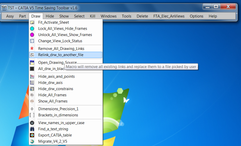

I have a drawing with several views, that drawing corresponds to several similar parts. So I create a drawing that I create a template, and now I want to recreate those drawings.
What's the easiest way to do it?
Replace links one by one?
Any macro? Anyone have built something similar, how?

if you create a 3D template and a drawing linked to that 3D template, and if all 3D parts are made from the 3D template (or from a part made from the template) then you will be able to modify the link of the drawing to the 3D part. (the template here is just a regular part, it is just that you use it to make the other part using files save as, of file new from)
if you made your 3D part as new file then you wont be able to link your drawing to it.

I have drawn all parts allready. It means that now I'm unable to relink the drawing?
Ferdo I haven't seen lately your tst. Do you have a tool to do it?

Ferdo Need your help.
What should be in Product1?
I have tried the document file, and there is an error
DrwView.GenerativeLinks.AddLink Product1
I have tried open the file and use the value of Product1, and error again
Product1 = documents1.Open(strFilePath)
Can you help me?

This is what I wrote.
CODE --> vba

Found it. I was forgeting to put in addlink Product1.Product
CODE --> vba
