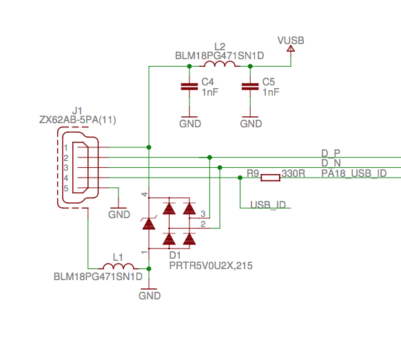

You are right, that seems to be the issue: If I supply the GND from my power supply to the GND of the USB connector then it's all good - but: If I tie the GND from the USB to the GND pin of the board than I am back at my wrong results. How does that make sense?
Two different GNDs?
RE: Issues with analogRead when using Vin on Arduino
Correction: it looks like I am not connecting to USB GND directly
I am connected to the USB shield which has a ferrite bead (BLM18PG471SN1D) in line with it.
