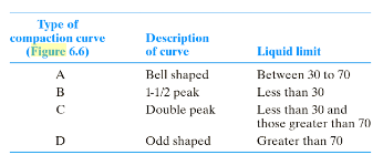

can someone provide me with an example with a double curve phenomena and which material is it
RE: Proctor test
Ok so Lee and Suedkamp 1972 studied the forms of proctor curve and they relate some of them to the liquid limit of the soil
