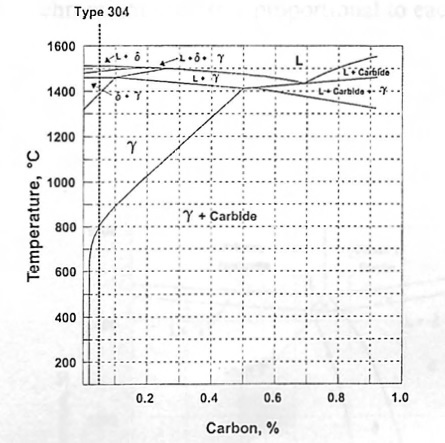

By the way guys, just one more question. I read somewhere that the microstructure of stainless steel 304 will keep being Austenitic even if I increase temperature because of the composition that stabilizes austenite, the only thing that will change is the formation of carbides and intermetallics.. is this true? What about the 446 ferritic structure?
RE: Rapid Solidification 304 Austenitic SS vs 446 Ferritic SS
Yes, the 304 will stay austenitic clear to the melting point, and there may be secondary phases depending on composition.
If your material is low C and low N then you may need thousands of hours at high temp to form any other phases.
The ferritic will start to form secondary phases at about 300C, with rapid formation at 475C.
Then as you go higher in temp some of these phases wills tart to dissolve and others will form.
A ferritic stainless will have good ductility when hot, but if it has been above 300C for any time the room temp ductility will be very poor.
If you dl this book it has figures that show which phases will form in which temp ranges.
https://www.nickelinstitute.org/en/TechnicalLibrar...
Attached see phase diagram for 304, when heating it to a temperature above the single-phase austenitic field, i.e. above about 1380C at .05% carbon, primary ferrite will re-form in the alloy. This residual ferrite (in as-cast condition) may or may not a good thing.
