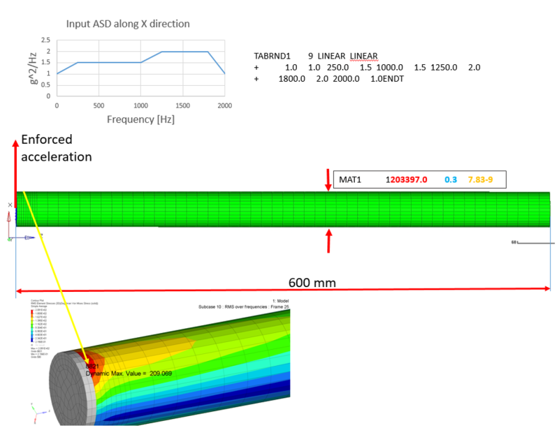

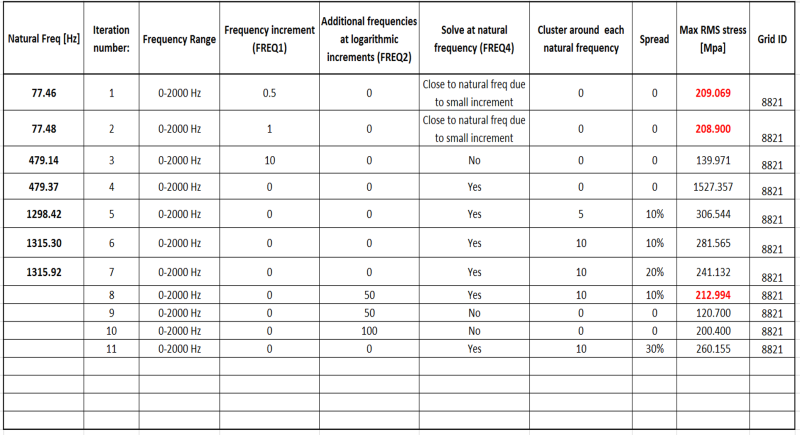

Thanks again. Please see below the problem specs and also the stress results for one of the iterations I am doing. The stress seems to be stabilizing around this value (209 MPa).
Also in the attached sheet I played with different frequency steps and recorded the max stress results.
Please let me know your opinion.

I guess the material density you provided is not correct. I guess you meant 7.83e-3 instead of 7.83e-9 ?

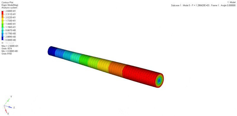

I don't get you mode #5, what are your boundary conditions? I guess it is fixed at one tip and free at the other, i.e. cantilever beam...?
RE: Random response analysis - Nastran
I am using tone/mm^3 for the density units. This is why it is 7.83e-9...
The BC's are cantilever beam indeed.
The mode #5 is a torsional mode (see below). Are you using CBEAM/CBAR ? Maybe this is why you are not capturing that mode..

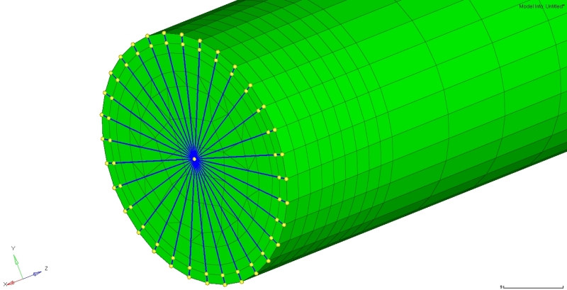

Sorry for the late reply. I am using a RBE2 spider which grabs the nodes highlighted below.
The acceleration is applied at the center node.

now, by checking the model, the material units seem consistent with the geometry dimensions and applied load
I did run the random analysis with a different frequency function generated in another preprocessor - see below
FREQ 269.7130369.7293873.5859873.6032377.4589377.4770981.33187+
+ 81.3509485.2048285.22479431.2041431.4025455.1599455.3693479.1157+
+ 479.3361503.0715503.3029527.0272527.26971167.9121183.4091184.042+
+ 1232.7961249.1541249.822 1297.681314.8991315.6021362.5641380.644+
+ 1381.3821427.4481446.3891447.162
With exact same conditions as yours, appart from the frequency function, the maximum RMS stress obtained was 234MPa
in x-direction. if this is your objective I think your results are good enough
