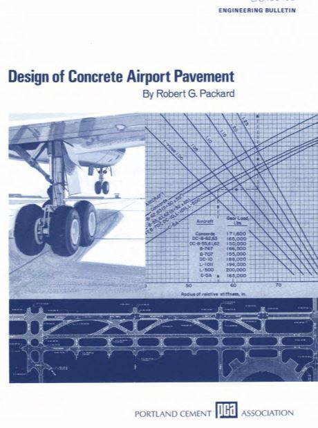

I almost did a similar project a couple of years ago. Looking at the typical detailing was quite daunting for me as a buildings guy. Thick slabs and lots of particular jointing that was unfamiliar to me. Frankly, I was grateful that the thing didn't come to pass. I did come across the resource shown below which was some help to my airport SOG edification. I do believe that the recommendations in that document are intended for a more serious level of airport traffic however. Runway etc.

KootK:
Great publication from 40 years ago... have used if for lots of runways and taxiways... really handy. I have a copy of the original calculations by Packard for his Hankel solution... I picked up a copy of his original paper and never had the time to 'sort it out'.
Have used PCA's 'Airport' program for numerous slabs for wheel loading and rack loading. Have a 5-1/4" disc with a copy on it, and have a couple of 5-1/4" drives, but no means of interface. Airport was a great program and one of the most useful ones.
I cut my original publication apart so I could scan it.
Dik

So... I accidentally posted some copyrighted stuff previously. My bad. It was old as dirt and googled so easily that I wrongly assumed that it was public domain. Anyhow, some good has come of it. In the process of trying to find a purchase link (fail) I stumbled upon some other stuff that looks kind of relevant. And it is public domain.
