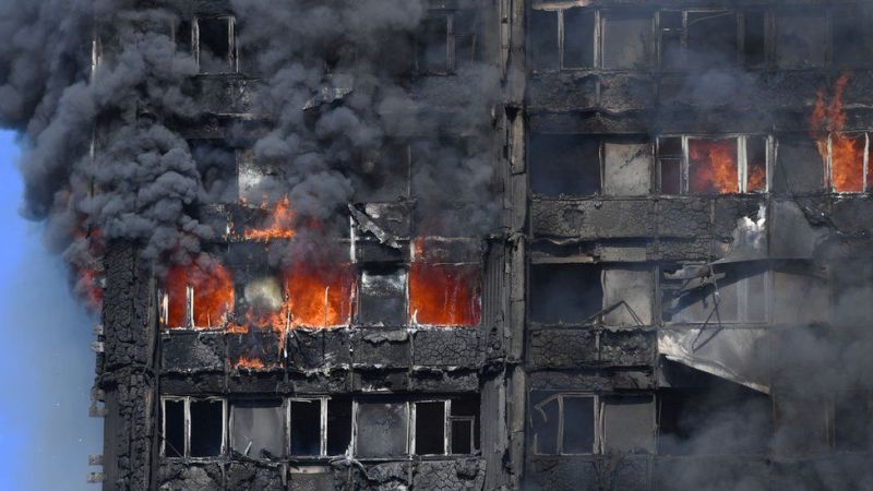

Looks like the building is fully engulfed. Residents trapped in the upper levels.
40 engine and 200 firefighter response.
RE: 24-level building tower fire in West London
Terrible fire. We can only hope that most of the people got out.

It is uncertain from reports so far if the cladding is the same as in the UAE fires, and the one in Melbourne. And yes, Australia has a big problem with this Chinese cladding. Don't know about the US.
Flammable cladding was my first thought too - some of the videos show what appear to be continuous tongues of flame tracking across several stories eternally - I'll be very interested to see what is confirmed in due course.

One report says the fire started as an electrical fire, a refrigerator. I had one experience with that sort of fire. The icemaker in our fridge started to smoke and smolder. No great damage done. Just had to repaint the kitchen. No icemakers in our house since that happened.
There must be a lot of companies who have gotten into manufacturing these aluminum faced cladding panels, so you can't go by brand names. That being said, the three brand names which have been mentioned in Australia are Alucobond, Alucobest, and Alubond. The similarity of these brands may be deliberately chosen to confuse. The Chinese made product which is reported to have contributed to the fires in the UAE and Melbourne is Alucobest.

epoxybot... it took 4-1/2 minutes for the flame to travel full height apparently.
Dik
Good observation, epoxybot. There was nothing to stop/start the fire going up the columns. But I doubt the details of fabrication made much difference.

The plastic film was created by molten plastic that resolidified as it was falling through air. In videos of the fire you could clearly see burning molten plastic pouring from the facade, and also strings and sheets of resolidified plastic floating in the wind.
What part do you think was plastic? Could that not be aluminum?
The section posted above shows the composite cladding connected to the concrete by some sort of bracket, presumably installed through the insulation. I wonder how that was done. And what held the insulation in place until it was restrained by the cladding? Glue? That is a rough architectural detail, done by someone who didn't know how it was going to be put together. I wonder (again) if there were shop drawings.

So, the vertical column facings burned very, very rapidly upwards, causing massive vertical smoke and hot gasses right next to the open windows adjacent to the vertical column facades. Smoke got brought into the lower-opening windows by drafts, and the open windows removed any fire break effects of the normal cladding. Over a few minutes of time - 10-20 minutes perhaps - and the fire lasted hours, each individual window insulation and its plastic surrounding above the foam and cladding outside would fail, although slower than the vertical column facades. Worse, the smoke and flames coming in from the vertical fire outside the windows would "prevent" people from running to the windows and closing them, which will increase the number of windows left open as people run out the doors of each apartment. So the natural draft (outside cladding fire through window to door inside to hallway) increases the smoke load in the hallways and stairs.

Other point is that unlike the drawing, the reality if you look at the photo from epoxybot is that the windows are designed to tilt inwards at the top or open inwards. Both designed to stop things accidentally falling out of the window from an internal sill, but if left on vent by tilting inside will have fed flames and smoke into the flats very quickly, probably burning curtains etc.

From the movies taken, it was pretty obvious that the propagation of the fire was via the building envelope with some type of stack effect bringing the flame into the structure.
stookyfpe:
I don't have a handle on UK codes, but, I know that the flammable cladding is not permitted in Canada, and, I understand it is not permitted in the States.
The error is that the wrong material was used for the cladding. An architectural design error, at very least, or a substitution by the government, possibly with the blessing of the Architect.

Looking at the films, the fire developed on the exterior prior to moving inward. It appears the roof is gone, and it may be that the elevator shaft and/or the stairwell created the stack. I don't know and this may come out. The exterior fire was sufficiently developed that when it moved to the interior the sprinklers may not have been effective; the consumables may likely have been outside the reach of the sprinklers. Sprinklers may have reduced the consumables and lowered the temperature a bit, but, I think most of the flame was on the outside out of reach from sprinklers. Hopefully a better understanding of the situation will evolve.
Should have added that if the initial fire was suppressed, then none of this would have happened... and in that manner, sprinklers would be great.

The facade supplier appears to be OMNIS. While Reynobond PE is the suspected culprit. OMNIS produces & supplies more than one brand of ACM. They have removed their ACM .pdf spec sheet from their website. OMNIS had bought out Rigidal while it was under reorganization; right about the time the facade contractor, Harley was the low bidder...,
The Celotex type insulation doesn't strike me as the overwhelming fuel component. Much of the charred insulation remains in place on the spandral panels and large lightly scorched pieces of it are on the ground where they came away from the columns. It is the ACM low density polyethylene LDPE core that burned so rapidly. Same material as a plastic milk jug. Unlike the Celotex, it is a thermoplastic instead of a thermo-setting plastic. It melts, that's why it is used to make milk jugs in high volume. You can also find LDPE in many commercial waxes. Unbelievably, the people responsible, basically turned this building into a candle. Ingenuity's Red-Bold earlier post is very informative as to how this fire spread both up & down the facade. Cut up a milk jug and light a piece of it on fire, it burns very easily.
Both Kingspan and Celotex are made of the same stuff: polyisocyanurate - thermal conductivitity k is stated to be 0.025w/m/K.
While that for mineral wool used on external walls has a k value of 0.035w/m/k.
Have a read of the fire risk para in Wikipedia on the topic polyisocyanurate.

It's my understanding that the issue with cladding material in multistory or high rise buildings isn't just with the cladding material but the entire assembly as a whole - including installation details. Each installation and any additional "layer" to a wall needs to be tested separately because fire can react to each assembly differently.
PIR foam is a thermoset material which means - while combustible, they form a char and doesn't contribute to the spread of flame. That being said, any foam plastic still needs to be separated by a thermal barrier or be tested as a thermal barrier. The ACM material however, is a thermoplastic which can melt and ignite at lower temperatures.
I'm not too familiar with the European codes, but typically foam plastic insulation and metal/aluminum composite materials need to be tested via FM 4880 and NFPA 285. These are tests that measure the flame characteristics of the foam as well as the cladding assembly in multistory buildings. The Grenfell tower installation looked different than what Reynobond has in their ICC-ES report. Building codes would have different requirements for materials rated with different types of flammability characteristics which are intended to prevent disasters like this.

My calcs tell me that, with the 150mm of PIR insulation, 50mm air gap and a composite aluminum skin with 4mm core LDPE layer cuts down heat loss to 15% of the bare wall heat loss, which clearly justifies thermal insulation. The biggest resistance to heat transfer is the insulation.
Replacement of the PIR insulation with the same thickness of rock wool insulation cuts down heat loss to 18% of that for the bare wall, so about the same thermal performance as PIR insulation.

So the original outreach presentation, by Studio E Architects to residents, included two cladding materials VMZ - Zinc/FR-PE Composite & Marley Eternit - EQUITONE fibre cement facade panels.
An interesting factoid is the Limiting Oxygen Index (%) of a given material. The Limiting Oxygen Index (OI) is a convenient test to make preliminary determinations about the flammability of a given material. It is the amount of Oxygen needed to self-sustain a flame. Atmospheric Oxygen at sea level is 21%. I have read values of 23% & 28% as the value needed to render a material non-flame self-supporting. Paraffin has an Oxygen Index of 16% & Polyethylene (PE) an OI of 17.4%. Most of the data on Polyisocyanurate (PIR) is behind "pay-walls" but the most common IO reference I found was 22-23% and one as high as 29%. With such a minimal need for Oxygen, one would think that PE would burn like a candle but its vapor pressure limits its combustion. A caveat of the Limiting Oxygen Index test is that the flame is applied to the sample from above and the buoyancy of the flame, limits the ability of the test to yield real world results. Many of the most fire resistant materials drop by as much as half the OI% when the flame is applied to the bottom of the sample. This is not true of Polyethylene, it remains at 17%. So one can conclude that the vapor pressure of Polyethylene doesn't make it the best combustible material but its low requirement for atmospheric Oxygen makes it a great fire starter. How good a fire starter is Polyethylene? It has a heat of combustion just shy of diesel fuel. Heat of Combustion in MJ/kg: Paraffin 42-46 / Polyethylene 44 / Diesel 44-45.
A likely scenario is that the burning of the Polyethylene creates a heat column sufficient to render any fire resistance that might have existed in the PIR insignificant. Even though much of the Polyethylene melted, the melted PE would have pooled on the firestop blocking between floors. Molten Polyethylene retains a remarkable amount of heat and would have radiated that heat back up the void creating a flash-over condition & compromising the PIR very quickly. At about 900C the vapor pressure of Polyethylene has no deterrent effect on its combustion and it burns like a paraffin candle, completely leaving zero waste product.
Regardless of the materials that turned Grenfell Tower into a candle, the question should be asked; "Who started the fire?" and considering the very serious electric problems Grenfell Tower experienced in May 2013, the wiring of the building in the undamaged flats needs to be given a thorough forensic inspection and the purchase orders of the electrical contractor examined to determine what remedial measures were taken. In the UK, electrical wiring is typically installed on a 32 amp Ring Circuit and electronics & appliances are protected by fused wall plugs. A refrigerator would have had a 13amp wall plug but they don't blow until they exceed 20amps. If you share your ring circuit with your neighbors (all the units had in-flat prepaid-meters) you can experience a power surge when something like the washing machine of refrigerator draws a high current when the motor starts. And then, their are the tenants of a building who had experienced so many power surges & brown outs; changed out so many fuses on their electronics & appliances. Many who came from undeveloped & developing countries are used to coming up with work-around solution that compromise safety, like hot wiring the fuse holder.

epoxybot - although the columns do appear to have been insulated as you can see evidence on the photos I wonder if the deep corrugations on the column allowed flames / air to pass up the inside of the insulation or whether the insulation in those sections was not as thick. Clearly any fire stops on the columns were useless if indeed fitted and long vertical sections appear to be the clear accelerating element.
LittleInch (Petroleum) - I think the trapezoidal relief feature proved to be a difficult surface for the workers to mechanically secure the insulation to the columns. The insulation charred much like what remains on the spandrel panels but the longer sections of charred column insulation fell to the ground during the fire. The trapezoidal area is about 25% of the surface area of the column face and if char formed on the back side and resulted in some expansion, then it pushed the insulation panels away from the column increasing the air gap & fire until the char collapsed. Here is a good photo of the cladding assembly & the fire stop blocking. On the columns, it looks like the fire stop is all that secures the insulation in place. The horizontal presentation of the spandrel insulation, confinement top & bottom plus the fire stop seem to be what held the spandrel insulation in place, for the most part.
Quote (LitteInch)
I think you may be correct. Looks like they used cold-formed steel to offset and attach the PIR to the existing column exterior, and creating an additional cavity: Plan-section of detail:

This seems to be the route of ingress of fire debris behind the cladding. The cold-formed steel hangers for the cladding form a boxed U-shaped channel. As flammable debris cascaded down between the gap between the 4th floor Column ACM cassette/panel & the Spandrel ACM cassette it would have channeled much of the debris to the inside of the 3rd floor Column ACM cassette. I'm speculating that the black material along side the insulation, is window flashing with a bituminous composition. Some of the flammable debris would have landed on the bottom of the forth floor Spandrel ACM cassette (3rd floor window soffit). So the "Hook & Pin" method of ACM suspended cladding installation created a vulnerability.
The window frames did not extend column to column. The vertical edge of the window frame stopped 6 inches or more from the columns. What was used to fill in this void is anyone's guess but it is this design attribute that compromised the compartmentalization of each of the flats. The use of, what I assume, is a ?rubberized/bituminous? window flashing, primed this void with a material much more flammable than the Reynobond Polyethylene ACM or the Celotex PIR Insulation board. The composition of such a material is a mixture of: Heavy Paraffinic Distillate Solvent Extract CAS# 064742-04-7 , Petroleum Asphalt CAS# 008052-42-4 & Styrene-Butadiene block copolymer CAS# 009003-55-8. The HMIS - Hazardous Material Identification System used on Material Safety Data Sheets, identifies such a composition as having a Fire Rating of 1. (Slight Hazard Materials that are normally stable, but can become unstable at high temperatures and pressures.) It has a flash point around 210C and, if left exposed, would be the most vulnerable material in the assembly.
The design decision to use the ACM Column cladding as the vertical edge of the window opening, doomed the safety of the interior of the flats.

dik (Structural) - I don't disagree. For the contractor, it comes down to the windows. They were able to use the same left hand & right hand windows on all 4 elevations by staying with just one size. It violated the Environmental Planning done with respect to natural lighting as set forth in the commissioned BREEAM study but it was less money, maybe.... The building required a total of 294 windows on the upper 21 floors. Instead of buying 84 Left-hand Windows & 84 Right-hand Windows, sized for the North & South elevations AND buying 63 Left-hand Windows & 63 Right-hand Windows sized wider for the East & West elevations. They bought 147 LH & 147 RH windows all of a smaller size. So it seems, they adjusted the volume of the column cavity to accommodate the uniform window sizing.
epoxybot - excellent drawings, pictures and commentary and it has been a thing I struggled with as well which was of course the outside cladding shouldn't catch fire and spread like it did, but even so how did it catch the whole building like it did and enter the flats as quickly as it did. Gaps around the window frames filled with something very combustible was my thought and this seems to give weight to that theory.
There was something very odd / different with those columns though which may or may not be replicated on long vertical sections on other buildings. Your picture in the post of 16 June 21:28 is still the most dramatic and alarming of the whole sequence leading to this appalling loss of life and injury.
