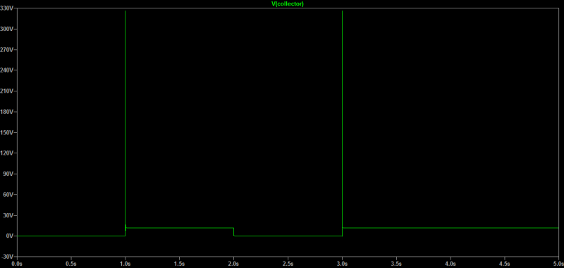

To measure the voltage spikes, I created a Node called Collector which I attached to the collector of the transistor.
This node is plotted on the graphs that follow.
The circuit as you see it is in "no suppression" mode. The plain diode across the coil is not connected, and the zener is not connected either.
Spice can run the simulation with these disconnected components and they have no effect.
To engage either suppression method, I just have to draw the wire that connects the component.
Here's the voltage plot at the Collector with NO suppression:

Footnote: When I set the resistance of coils 1+2 both to 225 Ohm the simulation gave me a huge hash that I assume is resonance or ringing on the Collector that never damped out. When the value of coil 1 or 2 was set to a slightly different value the ringing disappeared quickly. The plots above are at 225/220 ohms, respectively, and have no more ringing.
Hope this is helpful or interesting!

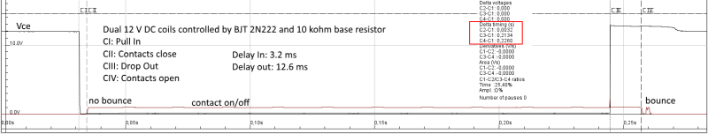

My 2 (maybe 3) cents:
I hooked up two 12 V relay coils in parallel and tested with different combinations of 1N4118 (no zeners) and resistors in series with it.
The recordings have been augmented with comments. First - no series resistor:
The kick-back voltage is, as expected, very low (one diode drop) and the off delay is 12.6 ms. There is bounce.

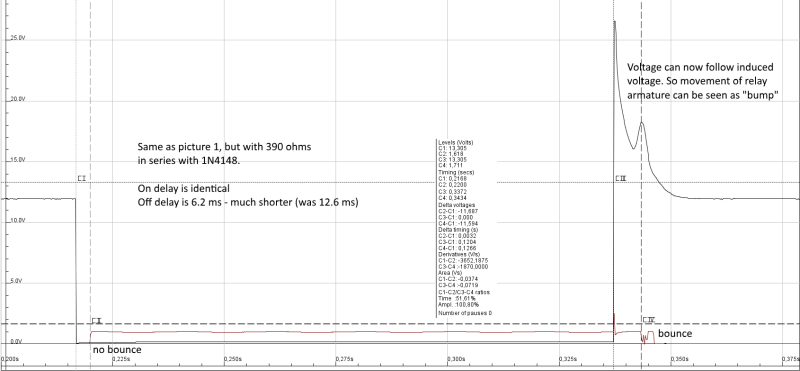

Next is with the 390 ohms resistor:
Kick-back is ariund 25 V, also expected, and off delay is now shorter with 6.2 ms. Not much influence on bounce.
I also ran a test with 2x390 ohms. The delay is somewhat reduced and the kick-back is higher. So high that the measurement range was exceeded. So no further comments on that one.

A subject like this is not something that one shall "discuss". Like all engineering, it is about setting up criteria that need to be filled and then either use your own knowledge or the collected knowledge of manufacturers and other engineers. Even text-books can be a valuable source of information. "Discussions" and chats where the level of the participants is unknown usually leads nowhere. This thread is partly showing that.
If the delay as such can be tolerated, then use a simple diode. Delay will typically go from less than 5 ms to between 10 and 20 ms.
If the delay cannot be tolerated, then add a resistor in series with the diode. As was done in my
18 Jun 17 19:11 answer, second picture. Delay is then reduced from (in this case) 12 to 6 ms. Doubling the resistor doesn't help much (a reduction of delay with another millisecond).

P.S. SparWeb, I am unable to download your LTSPICE file for some reason (it results in a blank web page):
http://files.engineering.com/getfile.aspx?folder=6...
And my PartSim simulation (Transient Response) is way off with the spike being in the kV range:
https://www.partsim.com/simulator/#82014

1. The test shows coil voltage (brown traces) with a diode and also with a diode plus a 1200 ohms resistor (twice coil resistance)
2. The black traces are contact position. The movement is around 1 mm. A little less, actually.
3. The orange and yellow traces show NO and NC contacts and how they conduct.
4. The release speed is totally independent on if you use a single diode, diode plus resistors, zener, RC or MOV.
5. All that changes is delay. And that is of no concern in this application, if I understood you correctly.
