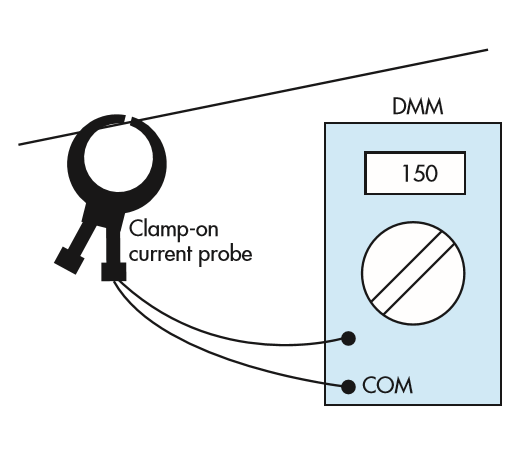

Before throwing the “book” in the waste bin, I couldn’t help noticing that the author doesn’t have a clue how to measure current with a clamp-on current probe. What he shows is something that seems to measure the cable diameter (yes, jaws open) and the important soft-iron area is thinned out where the jaws meet. Like a tool used to measure diameters in a lathe.

That current clamp measurement intrigues me. Has the author ever seen a CC? Or used one?

Sorry, I think you're being a bit nitpicky on that one. By your description, it's a not a user manual for clamp-on probes, and the picture may be a composite that's attempting to present a couple of different operations in the same drawing, which was a partial failure.

RE: Why do large companies punish relatively innocent EE:s?
No, I can't think of any valid use of a clamp-on probe the way it is depicted there, unless one were using it as a crude caliper on unenergized conductors.... That depiction might give an unfamiliar user the idea that the jaws must be touching the conductor, and an open jaw split core CT is not only going to fail to give them a meaningful reading, it's potentially dangerous because the jaws will vibrate and may cause the user (if holding it) to over react around live conductors, or if left in place it may fall off and hit something else. So I'm with Gunnar on this one, that's not just sloppy, that's bordering on criminal negligence.

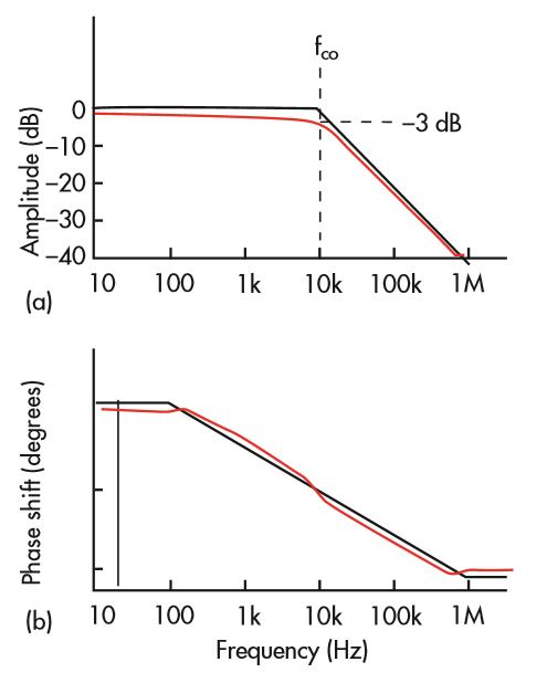

OK. If you don't know about current clamps - you surely know about Bode plots? Am I nitpicky when I ask you to consider this "masterpiece"? Licencia Poetica taken a bit too far. Don't you think?
I do know and have used clamp-on probes and Bode plots. BUT, these are cartoons, without adequate context, I don't know who did them, why they were done that way, etc. Sure, it's definitely desirable that they be correct, but what are you trying to accomplish with the posting? Why not directly contact the author/company to get it fixed?
So, the text that references that figure says, "Instead it uses an accessory probe that clamps around the wire whose current is to be measured (Fig. 2.7)."
So, certainly sloppy editing, and you're welcome to give Lou Frenzel a piece of your mind, and mine, if you so choose. I'd be terrified of working with any engineer that doesn't recognize the figure as being problematic. If I were in the position to hire EEs, I might actually consider that passage a gateway test for new applicants.
