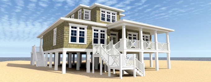

Can a house be built directly over a spring head? if permits(state, fedral) are obtained, can I do it? and if done are there any recommendations for methods to accomplish that? would a French drain system suffice? What are future complications and issues that i need to consider? Any help will be greatly appreciated.

Yes... but not with the approach you appear to have in mind. When a house is over water or even a wet area, don't want the living space coupled with the ground. The Owner will have ongoing moisture / mildew / mold issues no matter what steps are taken (e.g. vapor barrier, french drain, sometimes even forced ventilation of a closed crawl space).
Best to have natural ventilation between the living space and the ground:
