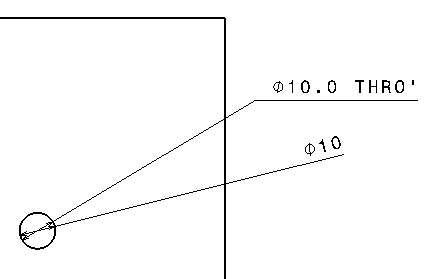

The 2-part dim line is basically the dimension reads horizontally.
I have attached a jpeg, cant see the upload image function? If you can point me to where it is ill upload it.

RE: Catia Macro programming Help
CODE --> code
Dim myDim As DrawingDimension
Set myDim = CATIA.ActiveDocument.Selection.Item(1).Value
Dim myDimLine As DrawingDimLine
Set myDimLine = myDim.GetDimLine
myDimLine.DimLineGraphRep = catDimLine2Parts
within 2 minutes of reading the chm file...
Eric N.
