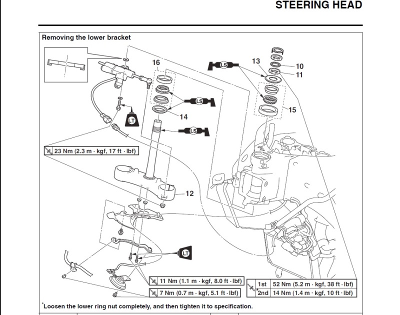

The Yamahas use two castellated ring nuts with a rubber washer in between to set lower bearing preload. The inital preload is pretty low- the torque spec for the lower ring nut is 38 ft-lb.
The spec for the big nut on the end of the stem is 80 ft-lb or so, but most guys just hand tighten them plus 1/4 turn or so. When you have the steering head apart a lot (i.e. if you're racing and replacing parts often) it's much quicker not to torque that nut to spec. There's almost no load on it so it's pretty common to do it this way.
Here's the R1 parts diagram for the lower triple tree clamp- you can see the two ring nuts and the tab washer that prevents loss of preload (or attempts to...)

Are those really caged ball bearings, not taper roller bearings?
"The inital preload is pretty low- the torque spec for the lower ring nut is 38 ft-lb."
I think 38 ft-lbs is an initial seating torque, to be loosened, then The final, operating torque is back down to 10 ft-lbs according to that diagram. Even zero rpm rolling element bearings don't think much of big preloads .
Is the stem a cylindrical diameter inside the clamp? Does the upper clamp slip off stem at disassembly? I think that the big nut is torqued to reduce/prevent micromotions of the triple clamp on the stem or vice versa. In time using reduced torque may result in fretting and wear of several surfaces there.

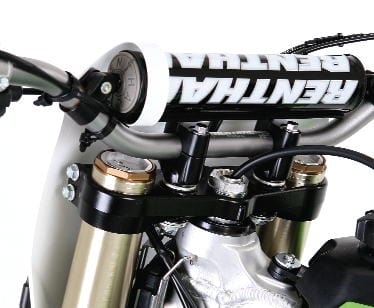

Actually, some upper clamp designs do clamp onto the stem.
RE: What is the reason the circular holes are equipped with tightening bolts?
Perhaps, but I've not seen one. In every case I've seen, the upper triple clamp is a slip-fit over the steering stem, and the top nut clamps the upper triple clamp against the top of the preload adjustment nuts.

This allegedly is an OEM MV Brutale upper triple clamp.
http://i.ebayimg.com/images/g/x~UAAOSwa-dWoQLa/s-l...
A few decades back the finest handling, best suspended off road motorcycle did it as shown in the attached image.
The triple clamp gripped the large nut, after the nut was tightened to clamp the TC against the bearing adjusting nut.
For those Timken bearings the adjustment was not a torque, but ~ zero clearance and absolutely minimal increase in rotating torque.
Some bikes had split top nuts, so when pinched by the TC, the split nut likely compressed and the threads gripped the stem.
I'm not real keen on threads ever being in the load path to provide location, so look at the axial clamping as the main preventer of klunks and even micromotions that would fret and wear things out in time.
You're correct that the two torques are initial (to ensure bearings are seated) and then the nut is backed completely loose, and tightened to 10 ft-lb.
The big nut that actually goes into the upper clamp is not shown in that drawing- it is the one I referred to in my earlier post, that a lot of race mechanics torque hand tight + 1 turn. This nut sees very little load in service.
