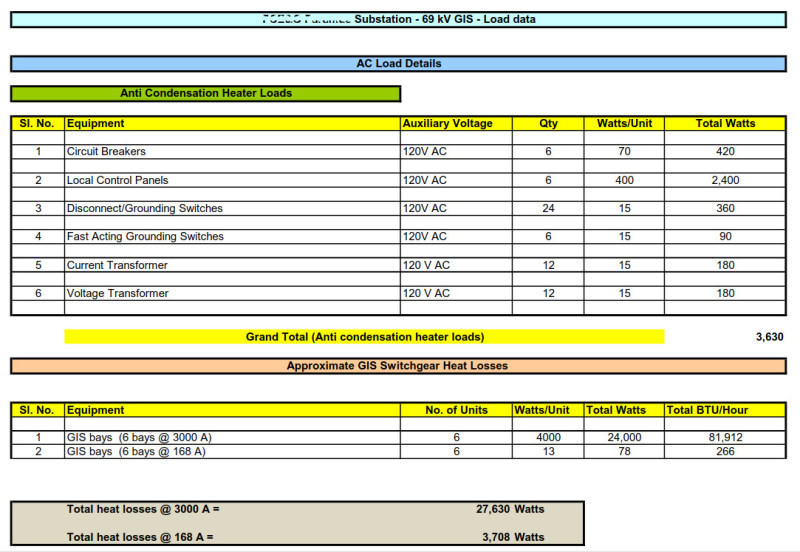

Below is an example of a GIS heat load used to estimate the fan size inside the building.
I hope the help
