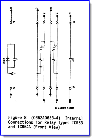

One of the relay on our main circuit breaker is a GE#12ICR53A1A, Ansi#47, Phase Sequence and UnderVoltage Relay.
I've read the manual but still not sure of how it works. This is from the manual:

The 47 relay is on 4.16KV MCB that feeds a line up of 4.16KV feeder breakers, that in turn provide cables underground to building transformers. The original purpose of this relay (I am told) was to protect the motors on site from phase loss, and/or, reverse phase rotation. There is a time delay time on the relay set to 3 seconds.

Can you post a schematic of how the relay is wired into the close/trip circuits? That will explain exactly how the ICR53A is being used. The left contact would be used to block starting of the motor and the right contact would be used to trip the running motor. If the left contact is in your motor start circuit, breaker close circuit, it would block the motor from starting if you have two phases swapped or if you have a loss of voltage on one or more phases. The left contact will only close once you have balanced three phase voltage on the bus. On undervoltage, after a time delay, the right contact would close to trip the motor offline.

Loss of potential on all three phases will allow the disk to roll to close the right contact. If this is in the trip circuit of the breaker, then the breaker will open.
Note that you can set any two of three parameters with this relay: Left contact close (minimum pickup voltage to allow operation), right contact close (maximum voltage that will trip) and time delay from normal voltage to closing the right contacts on zero volts.
three-phase voltage of proper sequence and magnitude turns the disk to close the left contact, making it the permissive for motor start, if used. Loss of a single phase will allow the disk to slowly roll to close the right contacts to trip. Complete loss of potential will trip relatively fast.
