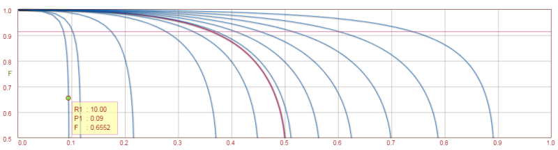

During my tasks in different disciplines, I am reaching some new performance measure as according to the topic studied. I already used multi-regression in some and, if that was not enough to fit my data, I used interpolation method 'The Vandermonde Method' and lately discovered the powerful griddata function by Matlab.
I need to derive new expression/equations for the data I reach each time (like regression coefficients so that I can use them in my model). My question arises since I have no idea how the old scientists could find the advanced expressions for their data (Please check the formulations below). For example, how one could put the relation for the correction factor as a function of R and P as given below. As you can see, the relations of R and P with correction factor is not straightforward to be understood. Normally the curve of correction factor seems to be power-like regression for each P with changing R values. But the formulation below is totally out-of-world.

Correction Factor - LMTD Theory(most inspiring one) :)

It will be rewarding to give the correction factor curve, its expression being the formulation that I did submit in my first post (but giving here as well).
They seem to have a characteristic of an exponential function for each curve (considering some coefficients being negative). So I tried to fit the data for my custom function a exp (b x + c) + d for each line in the graph (by use of Matlab optimization tool) and obtained (for two lines) that only the coefficients b and c change with changing lines. It results something but I didn't get satisfied with that. The custom function was generated by use of info given at Nancy Marcus - Graphs of Exponential Functions.
