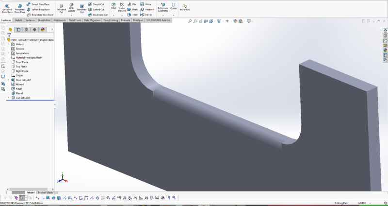

Hi all,
which is the right way to create a filet (or a chamfer) on the blue highlighted edge only (with no propagation on the near edges)? The normal fillet command has the "tangent propagation" function on, but if I remove it the program return me an error.
I attach the images.
Thanks in advice.

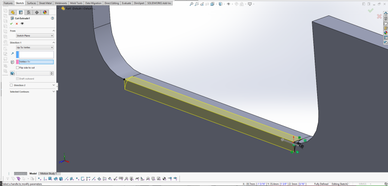

It's not super clean, but I'd do it using an extruded cut along the edge. I don't think the fillet command will get you there.
Assuming this is what you want..
RE: Fillet on a specified edge, with no propagation on the nearer ones
Yes that's it. Thanks a lot jgKRI.
I fear that it was the only possible way... thanks again

Or you could make a minimal (.00001 x R) cut thru on either end and then fillet.
Or you could create a multi-body part by splitting the model at the radial intersections, then add the fillet to the edge, and finally combine the bodies.
