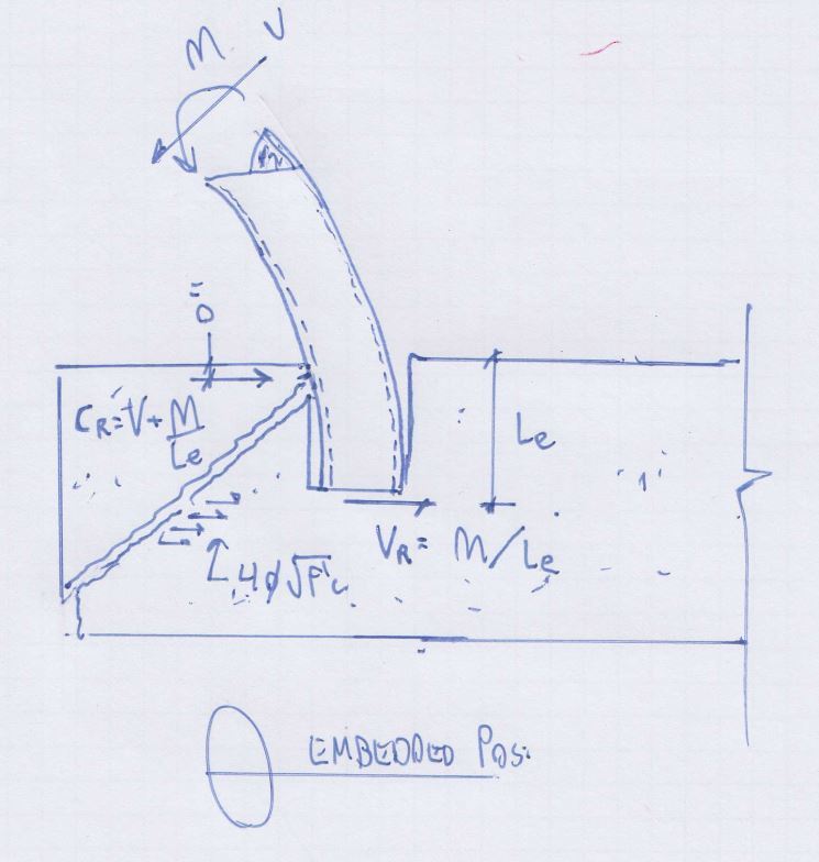

If you are proving the depth of fixity for an embed, check the attachment....
RE: Old Thread "Railing Posts Anchored with Non-Shrink Grout"
Thanks for the sample calc, Ron. I have reaction results from my calcs that are almost the same as using yours. The issue is the breakout at the edge. Currently, I have rigged ACI anchoring provisions. I also tried assuming a tension stress distribution to simulate a sort of zippering of failure planes. Both models resulted in under-capacity, but testing may be plausible.

I've had success treating it as a zero depth shear lug per ACI 349 provisions. I take the lever arm at the full embedment depth.

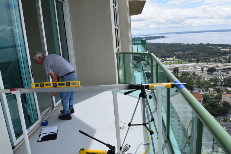

I understand the practical, definitive advantages of doing a load test on the railing.
50 lbs per linear foot, nominal 200 lbs per post if the posts are at their usual 4 foot interval.
But, where do you find the 200 lb test device? Surely not a bathroom scale turned sideways between the railing and a nearby wall.

racookepe1978.....here is our test setup for lateral load testing guardrails....

Curious Ron: state wide, what kind of failure rates do you see and what is the most common mode of failure?
KootK....actual failure rate is fairly low. Usual failure mode is either a weld failure, end anchor pullout, or failure to recover deflection (though that's not a code requirement).

Ron,
How much load do you apply and for what duration?
XR250....200 lbf lateral and/or vertical....it is immediate load and release. There are no criteria in the code (IBC and derivatives) for any duration or deflection limits/recovery. The applicable ASTM Standard (E985) does not have deflection criteria either, except for Public Assembly buildings. Otherwise essentially the same as building code.
Adding to my comment previously of a low failure rate....that is because we are usually working on higher end construction I think. Hotels in Florida are required to be load tested; however, we do little of that because of our fee. There are some out there who will do this test for $200. We can't do that.

Ron:
In your horizontal load test setup you are using the column/wall on the LHS as a reaction to the ram/jack force, through the horizontal SHS?
Is that a 5-ton or 10-ton capacity ram/jack?
Ingenuity. It is a 10-ton ram; however, the gauge is calibrated for lower loading up to 500 lbf. That way we can control the loading to much smaller increments.
Ron: Yes, a low-end calibrated gauge is important when a 200 lb.f load on a 10-ton cylinder (that is capable of 10,000 psi) is only at a pressure of less than 100 psi.
With a single-acting cylinder like the one you use (that uses a spring for the return) the calibration should consist of system-calibration (gauge, cylinder and pump) against a NIST-traceable load cell, not just a gauge calibration to a master gauge. At low levels of load the spring in a 10-ton ram provides considerable 'internal' resistance, resulting in less externally applied load/force, if using ram effective area x gauge pressure (which I don't recommend).
I usually use an external small-capacity calibrated load cell in these instances, for redundancy.
Sorry for the hijack, MacGruber22.
Ingenuity...same here.This is "system calibrated". We have several rams but we don't mix and match without separate system calibration. All of our equipment is calibrated with NIST traceability or other recognized standards if NIST traceability is not available...load cells, gauges, manometers, moisture meters, sound testing, etc.

KootK - the lug procedure is the way to go. Much more representative of the failure planes, I think. The only issue I do not like is that the bearing stress is not uniform as assumed in the lug breakout capacity (not to say that is was by rigging ACI anchoring equations!). I still worry about added tension from the moment about the btm edge of slab. The change in moment about that point is 18% when comparing a uniform bearing stress versus the "real" non-uniform, which in my case, gets me 5% under capacity. How have you rationalized that? Maybe your calcs never got that close.

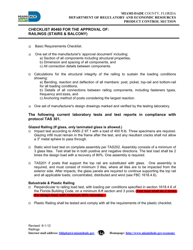

@XR250, if you were to test the rail to the 334-400 plf range wouldn't you expect the rail to yield, assuming that it was designed to 100% of the design load? I would expect you to load test it to the specified code load as this is the actual intended load for it to resist. We build in our factors of safety in the off chance that it does get overloaded, there will be plastic deformation and the rail will prevent collapse. It wouldn't be practical to test the rail to the increased load as you'd likely have to replace it afterwards.
Miami-Dade County has this requirement from Link:
IBC 2012, ASTM and AC test requirments:
Keep in mind that "test load" sometimes refers to the requirement for the manufacturer product testing in a laboratory-type test, not necessarily a field-type load test.
When I did field-load testing to a plastic/vinyl handrail system about 20 years ago, the AHJ required we test to 2 x 200 lb.f. But the max test load in this instance was moot, the system failed at less than 200 lb.f!!!

XR250....I finally understand your question! Sorry.
There are some items for which load tests are carried to 125-200 percent of design. Pile load tests for instance. Guardrails are not one of those items. The ASTM Standard for testing guardrails does not require an additional safety factor nor does the building code or life safety code.
I agree with the points Shotzie noted.

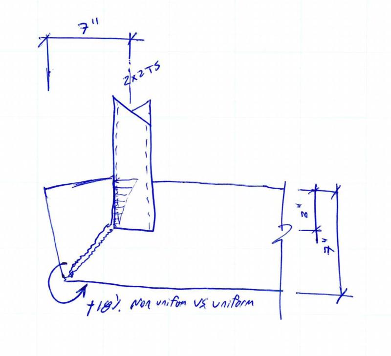

@MacGruber22: I clearly failed to communicate my zero depth lug intent effectively in my previous post. Let me know if this doesn't clear it up. My lever arm is admittedly aggressive. It's based on the deformation picture that I have in my head which is a me-specific thing. For many arrangements, lowering the center of compression will increase the size of the resisting shear frustum. It should offset some.
Sometimes, to remain solutions focused, I think that one has to do something other than make all of their choices conservatively. I'll probably take a beating for saying so in present company but I really don't care about guardrails very much. I believe the code intent for guardrails really boils down to "stout". If I can parse out a defensible evaluation technique that gets me in the ballpark of "stout", I'm happy with that. Functionally, doing otherwise means that my client heads down the road and gives his business to a crappier engineer who will produce crappier engineering. Thus, my semi-crappy engineering makes the public safer than some other guy's fully-crappy engineering. And I can stay in business. I know, that probably sounds more than a little arrogant. I'm cool with that. This is the place for the unadulterated truth to be told after all.

Ingenuity....your post points out the need for a consensus on guardrail/handrail requirements, which does not currently exist. The references in the Miami-Dade requirements to Florida Building Code requirements (FBC 1618) apply only to the HVHZ areas which are Dade and Broward Counties ( 2 counties out of 67 counties in Florida).....another pet peave of mine with the Florida Building Code. The code has provisions in the HVHZ sections that only apply to those sections, but should apply to all sections of Florida....many of them have nothing to do with wind loads (HVHZ means "High Velocity Hurricane Zone")

KootK - I should have asked what you meant by zero length. My bad. Consequently, in my case using a lever arm equal to a linear bearing stress distribution (with full-depth lug) results in about the same capacity as your generous full-depth lever arm with smaller frustum area.
