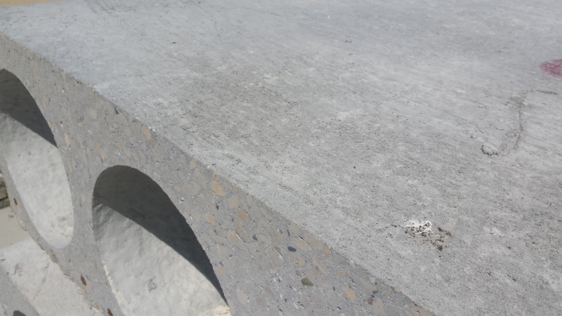

I'm helping a precaster out with the design of some hollowcore plank and some confusion has arisen regarding the required surface treatment required for the top of the planks. They could be left as cast, they could be intentionally roughened, or they they could be polished super smooth. As cast is obviously the cheapest and, as far as I can tell, there's no need for anything exceptional regarding finish.
There are two kinds of plank here:
1) Floor planks that get a 1.5" gypcrete topping only. No special treatment was specified in the contract documents.
2) Roof planks that receive no topping but only a roof membrane. Here the contract documents call for a smooth troweled finish.
So my questions are:
1) Could anyone point me to any photos of the various surface conditions? This would help the design team.
2) How would one describe the as cast finish on hollowcore planks? Would it qualify as smooth troweled?
3) Is there any justification for a roughened surface when using gypcrete topping? It's not composite, of course, but it should stay put.
4) At membrane conditions, is some degree of smoothness required in order to not damage the membrane?
When queried, the response that I got from the design team was "not smooth". I think that means as cast but I find it a bit ambiguous. All parties here --
including me -- are operating at a relatively modest degree of sophistication on this so just asking questions isn't getting me where I need to be.

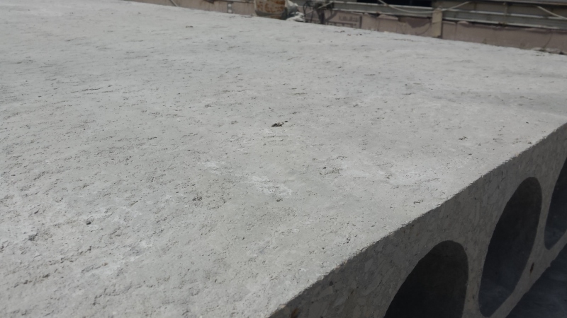

Hot off the presses, I have pics of machine cast, broom finished, and raked finished.

Interesting. For what it's worth, this IS my plank. Not google pics etc.

1) Agree with Teguci about the ICRI cards.
2) I would definitely say that it does not qualify as "smooth troweled".
3) In my experience a raked finish is only needed with composite topping without reinforcement at the interface. For other surfaces that require bonding but not composite action we use as-cast with moistening the plank to SSD and a scrub coat (or perhaps a bonding agent coat). You could also use powder actuated fasteners as shear reinforcement but that seems overkill to me and I'd just do a raked finish before I went that route.
4) Never had any issue with a membrane on troweled surfaces, but never really given this much thought either. Beyond just "no holes or pointy spots, please" I don't believe you'll have a problem.

The issue with the smoothness and membrane has become a VERY hot topic on a project we are currently working on. It is for the rehabilitation of a potable water reservoir that was originally constructed with a hollowcore slab roof. The roof was never insulated (left open to Manitoba seasonal conditions) and as such, deteriorated quickly. We identified many badly deteriorated slabs for replacement. The new design calls for an EPDM roofing membrane to be applied to the hollowcore roof as part of the new "roof envelope". We were receiving some very rough, jagged, slabs of simply extruded hollowcore which were all rejected due to concerns with puncturing the membrane. The protrusions had to be ground down on site to obtain a desirable smoothness. Although we finally got the surface finish to a quality we are happy with for applying the EPDM membrane, we couldn't find any true specifications out there for what is an acceptable surface finish. I agree with using the ICRI roughness levels as a specification if you know exactly what you want...
