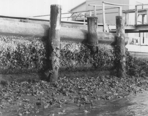

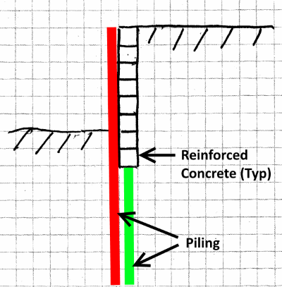

Thanks Hokie. Perhaps the OP can consider an updated version of a design my father came up with in the early 1960's. Instead of the considerable expense of constructing a 12'+ high, cast-in-place wall, use stacked, horizontal precast concrete members (they could resemble square concrete piling).
In the above diagram, the (red) piling resist soil pressure.
The (green) piling, spaced as needed between the red piling, keep the wall from settling when soils are poor.
The horizontal precast concrete members are stacked one-at-time, joint sealed - then backfilled, before placing the next horizontal member.
The photo below, which I took in the 1980's, is one of my father's walls. The horizontal members are salvaged 18" octagonal reinforced precast concrete bridge piling (from the 1930's). The vertical creosoted piling were very used, so have since been replaced more than once. This waterfront bulkhead, now 55 years old, is still in use.

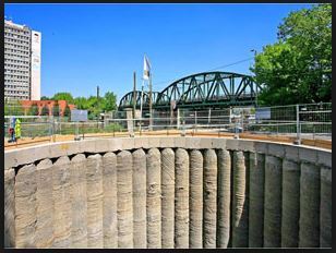

Seriously! If it is a basement I see very difficult to cast that wall without removing the ground around both sides.
Do secant piling and than Shotcrete the wall to make your waterproof solutions from the inside.

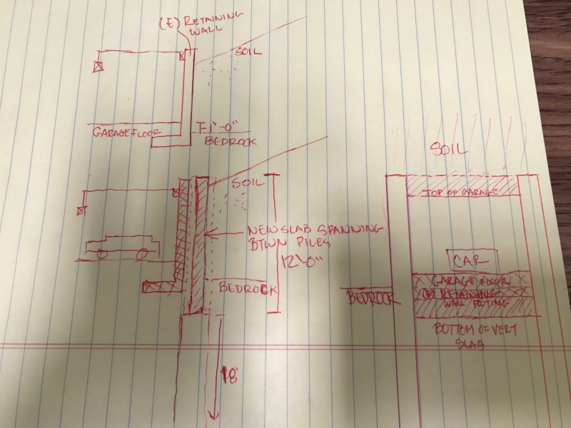

Thank you all for your input. I should've been clearer in explaining myself. It is an existing cantilevered retaining wall and is severely cracking in this section (as well as multiple smaller cracks along the length of the wall) and they are looking to repair it temporarily before the HOA approves costs and plans to redo the entire length of the wall(~60 feet long retaining heights that vary between 3' and 14'. This is for a single car detached garage (less of a garage and more of a shade structure placed in front of a retaining wall, above ground. I have attached a diagram of what the goal of the slab behind the wall should be.
However, currently trying to pressure my boss that providing temporary shoring and building a replacement cantilevered retaining wall may make more sense.
RE: One-way slab acting as retaining wall
Can the new wall lean against the existing wall such that the new wall could be considered laterally supported top and bottom? If so, then it should be a pretty straight forward design of a vertically spanning thing. If it's cantilevered, that takes me back to this:
