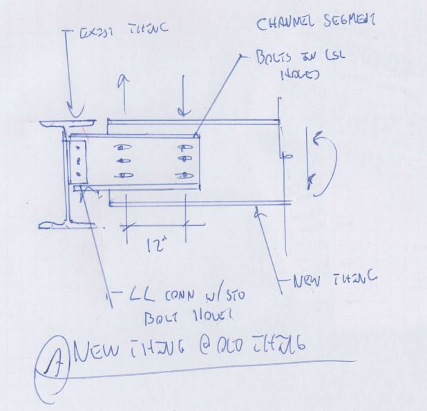

My question stemmed from doing work for retrofit jobs. Connecting into existing steel almost immediately requires the use of long slots (unless extensive surveying is conducted and even then does not guarantee successful bolted connections). When connecting a new beam to an existing beam that runs perpendicular, we often like to stop the new beam short of the toes of the existing beam flange for ease of erection (i.e. new beam is not coped to fit inside existing beam). Working for a steel fabricator (and especially for retrofit jobs) we are not always privy to all loads in the structure, so intentionally developing moments and torsion by not accounting for moment resistance @ the bolt line is neither conservative nor good practice.

This is a method that I've used in retrofits to easy installation and inspection. Got the idea from some cladding support beams the Seattle public library.

Thanks for all your input on this subject KootK. The connection you showed would definitely do the trick. It's not one the company I work for uses as a standard, but good to keep it in the back of my head for a rainy day. I have seen this type of connection in the field once, but they used the channel merely as an extension piece because the beam was cut too short (field welded instead of bolted though).
