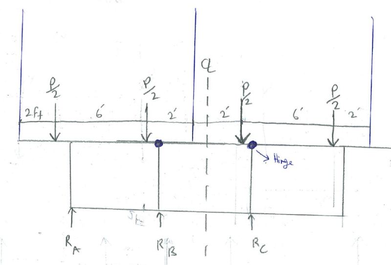

RE: LLDF
Dear all,
I have confusion wrt lever rule. In figure below, I want to find out LLDF using lever rule for exterior and interior girders on three-cell box girder.
  • for exterior girder one lane loaded, I found the fraction of truck loading multiplied to 1.2 for multi-presence factor. For two lane loading, shall I use the same fraction of load multiplied by 1 for two lane loading or I have to calculate again?
  • for interior girder one lane loaded, cay I say '(1-reaction at A obtained above) * 1.2 ' obtained above? Since for one lane loading only one wheel is going to first interior girder. In case of two-lane loading, two wheel loads are going to first interior girder, right? If so, then we take moment about point C to get reaction at point B multiplied by 1.0 (for multi-presence factor).
  • Please correct me if above procedure is inaccurate.
