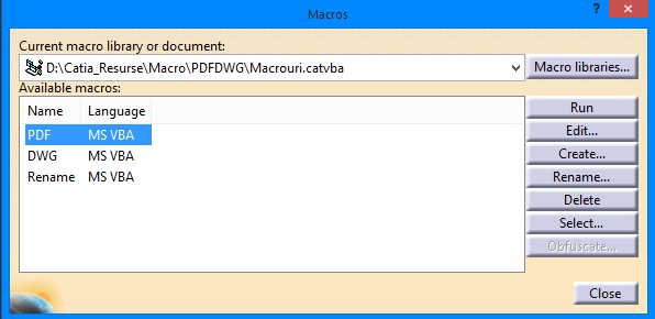

You can find attached a macro that I use, I think it was also downloaded from here a few years ago.
You need a structure like below:
The catia drawings and PDF and DWG folders must reside in
D:\MACRO_PDF
You can change this path by editing the script.
Fist you must copy all the catdrawings in the respective structure.
You just click the desired option, PDF or DWG and the script automatically cycles through the catdrawings, dumping the PDFs and DWGs in their respective folders.
Hope this helps !
