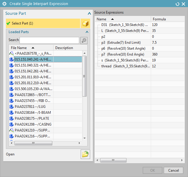

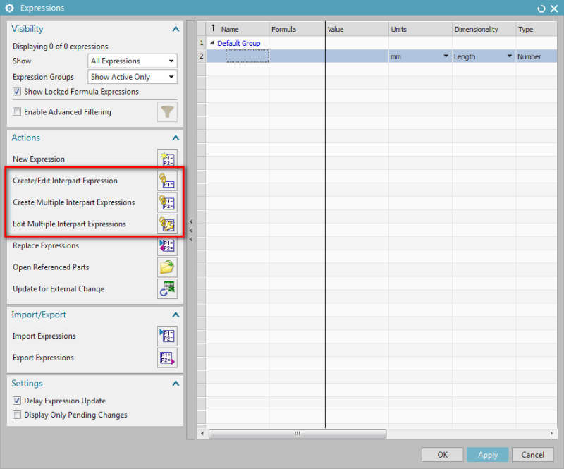

Handling Interpart expressions in NX11 is done by selecting any of the options shown below.
Which produces the following menu where you can select the part you want to link to, and the expression which is to be taken.
