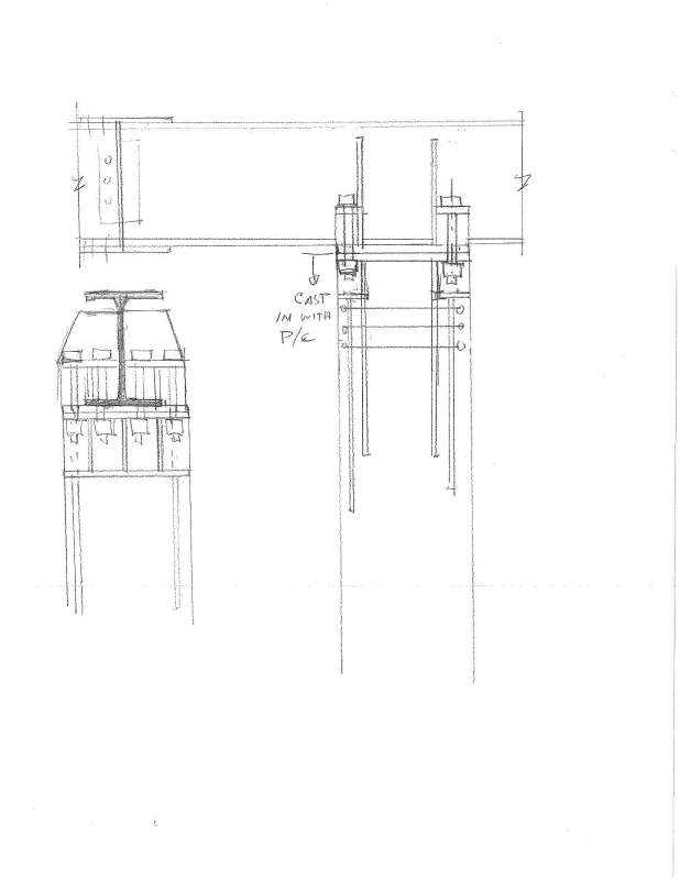

I have a design question for those familiar with precast and steel connections. I am designing the precast concrete for a 2 story podium style mixed use building. On the exterior of the building I have some precast columns which are supporting two wide flange steel beams. These connections have been called out by the EOR to be moment connections. I am looking for some advice/guidance as to how these members should be connected. The original detail the EOR called out for was simply extending the precast columns up to TOP OF BEAM elevation and butting the wide flange beams into a cast in embed in the precast columns. The problem with this detail was getting my studs to work in shear (I hadn't even got to the moment design issue). In discussing with the EOR we decided to drop the TOP OF PRECAST to BOTTOM OF STEEL BEAM and sit the wide flange members over the top of the column (with a 1" gap between both beams). This eliminated the need for two cast in embeds in the face of the columns. Now I just have to figure out (hopefully with your help) how these members are connected. Can I simply cast in an embed to the top of the column and weld the wide flange members to the column plate? Will this satisfy the "moment connection" needs?
Here are some examples of the loads to get a better feel for the project:
- 18x18 precast column
-Shear= 100-150kips (per beam)
-Moment = 290 k-ft
It's also important to note, most of the columns we typically design are simply supported, K=1.0, type columns. Does this change my column base connection?
Thanks in advance,
jReck

Glad we are on the same page. I was thinking of something very similar. See below:
Not sure if a fillet weld (as shown) would be correct or not for this type of connection?
And I misspoke earlier, the columns are 16x16 as shown in the detail above.
Thanks again.

290 ft K suggests that you need to put the moment forces directly into the precast column rebar - something like (4)-#10 per face. You could lap in some DBAs but HASs don't make sense to me. I'd also suggest making one beam continuous over the column and provide a moment connection for the other beam at a more advantageous location (where there is less moment). Welding to an embedded plate requires care since heat will expand the plate. Especially in this case where the welds will be significant.
Maybe, fabricate a column cap and shoe to provide for the 8 bolt connection (4 - 1 1/4" bolts per side). The column cap will have DBAs that lap with the precast rebar and will have side pockets to receive the bolts and nuts (MC4 facing out with cap plate and stiffeners?). The shoe will have matching holes and appropriate stiffeners to transfer the load into the beam.

Thanks for the response, could you provide a detail or quick sketch of your ideas please? Trying to visualize everything.

JReck... Your connection at the top is similar to what I've done... might move your splice point to about 1/7 span and use ql^2/12 for your design moment and use a bolted end plate for shear and moment transfer. With the continuity, your deflection is greatly diminished... about 1/3 of the simple span deflection. Add a stiffener plate at the support...

I would doubt the EOR wants to transfer that much moment into a 16x16 column, but think he just wants to cantilever the beam. But he is the one who should be making this decision, not us.
