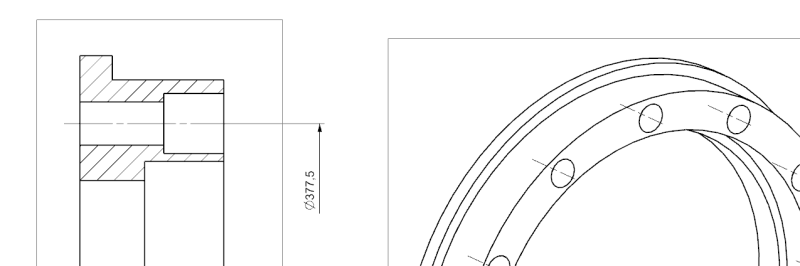

The pic below shows the center-line of a groove on the right and the correct dimension of 1.40 dia. The section view on the left shows 2 2D centerlines with a cylindrical dimension that shows 2X the correct value. What's up with that? Happens with NX9.0 and NC11.0.

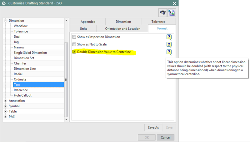

Hello Barnon,
You have to change this parameter:

This is a good old option for those who create large revolved models, that large and complex that it is suitable to only show half of the section. (- jet engines etc.)
Then IF you select the centerline ( ONLY centerlines will do this) as the FIRST selection AND ONLY for cylindrical dimensions, NX will double the value.
Then you toggle OFF that extension line and the Arrow , you have a dimension which is OK by the standards.
If you select the arc center instead of the centerline object , it will not happen.

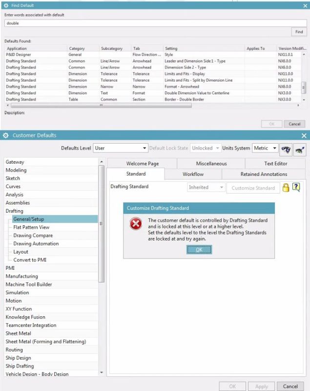

Ok thanks guys. I can't seem to edit that option. The only way I can find it is to search in customer defaults and the when I select it I get the error below.

IF you have the rights to change the drafting standard you can do following.
  • Switch Default level to Site
  • Unlock the setting (small lock on the right of the line)
  • Select the "Customize Standard" Button
  • Now you should be able to find it under Radial if I'm correct
  • Ok on both menu's and it should be saved
  • Restart NX for the changes to take effect
Keep in mind that if the site settings are locked you need to ask you administrator to make the change for you.

It's all greyed out. I've got the administrator looking into it. It's odd though, here at work we are on 11.0 but at home I have 9.0 and I can change that setting but even after changing it and restarting NX it still doubles the value when dimensioning to centerlines. Guess I just need to stop doing that.

Quote (Barnon)
It's all greyed out
This means you don't have write access to the DPV file.

It's as Ronald says, The "Site" or the "group" level has locked the customer defaults on your work. (You do not have access to the file in windows.)

I am running NX9 and the setting that controls doubling the dimension values to Symmetrical Centerlines is under Drafting -> Annotation -> Radial tab (not in the Drafting Standard) and happens to be unlocked at the User level.

No, possibly just put the radial/diametric dimension in the top view, add a note that it's to the groove center and move on or try a vertical or perpendicular dimension and prefix it with a diameter symbol if it MUST be shown in the section. Unless you are ALWAYS detailing small parts with no tiny intricacies that need detail views, I would recommend NOT changing the setting - as soon as you do, you'll need the other one for a detail view where you cannot show the full diameter of the area you're trying to dimension.
