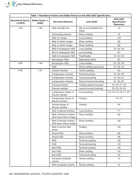

AISC's Engineering Journal article from 2006, Q4 entitled "Technical Note: Determination of Allowable Strength Design Safety Factors in the 2005 AISC Specification" Link lists safety factors and resistance factors based upon element type and limit state.
Part copy:
