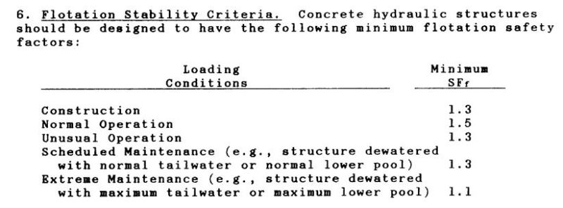

thank for your help and let me explain my situation
I design a pit now, and i dont need to consider wind load and earthquake at this area
if i consider combination 6 &7 and have not water inside pit
U = 0.9D + 1.2F + 1.6W + 1.6H ......................(6)
U = 0.9D + 1.2F + 1.0E + 1.6H.......................(7)
F=0, w=0, E=0
0.9D+1.6H
H including groudwater, this combination make uplift load too large (1.6 multi)
let my analysis model error (compression only spring have tension)
RE: Basic Question- about Load combination
I can't seem to find it here on Eng-Tips (I think i once posted it here). But I'll look at it when I'm back in my office and see if I can find it.
Basically it used different safety factors for different levels of water up the side of the tank (or pit) - with the highest level of water (i.e. perhaps at the ground level) having the lowest safety factor and the lower water level (such as half-way up the tank/pit) as the highest safety factor - i.e. I think it was 1.5.
I'll see if I can find that document.
Also - a copy of the safety factor table within that publication:
Very thank for your help and i check the safety against bouyant uplift.
i think ok .
But i think my problem is the loading combination to analysis stress and design rebar
as below
F=0, w=0, E=0
0.9D+1.6H ( disccount dead load, and increasu uplift load)
i would like to do not use these two load combinaiton
but i dont have any foundamental to support my idea , mabye i am wrong.
I dont understand why i must to use these two load combination
even i dont need to consider wind load and earthquake
