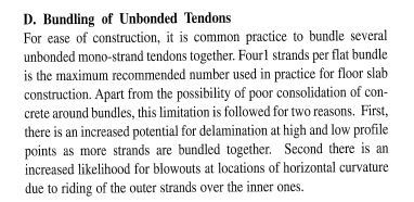

how many strands can be "bundled" for the distributed together.
This article recommends a maximum of four strands bundled on order to discourage delamination and blowout issues.
