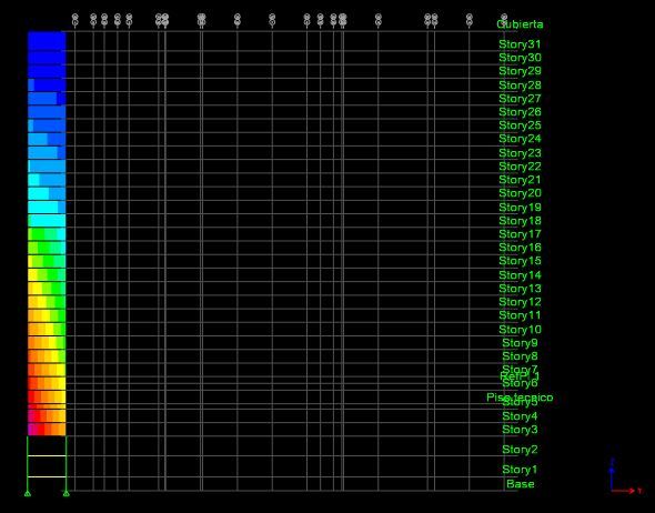

Hello Everyone!
I am working on a 31 story building and my boss insists to use deep beams as solution for the transition from walls to columns (it is a common practice in the office) but not for a 105 meters high rise.
today I am trying to prove his theory configuring a deep beam with 8.4 meters span and the program I usually use says to me that 10 meters height maximum.
As I understand the height of a deep beam may be relative to it´s span, and it has different behaviors when the relation Height/Span is in low ranges of 0.5 to 1 and an other when that ratio increases from 1.5 to 2.
I can preform a manual revision using struts and ties method, but I will have to design more then 10 different options by hand.
Please if you have any suggestions to my situation, will be appreciated.
Regards

Let me clear myself a little:
This is the view of my issue.
The options are due to the different span lengths and continuous changes in architecture that I have to face, usually I do a couple of hand solutions and check similar using software tools.

Are you only interested in gravity load effects at the moment? Or are we considering shear wall behaviour as well? Your stress diagram kinda suggests the latter. As Teguci intimated, there is rather a lot to consider in a shear wall application, particularly in a high seismic locale. No doubt you'll eventlly be considering shear wall behaviour as it would be quite unavoidable.
For gravity load considerations, my automation suggestion would be not to automate. An elastic computer model isn't going to be particularly helpful where you're dealing with strut and tie proportions and a non-linear, cracked material. Research suggests strut and tie models like those presented in the other thread that I linked are appropriate. Under concentric load, that will effectively make your "beam" depth about L/2.
