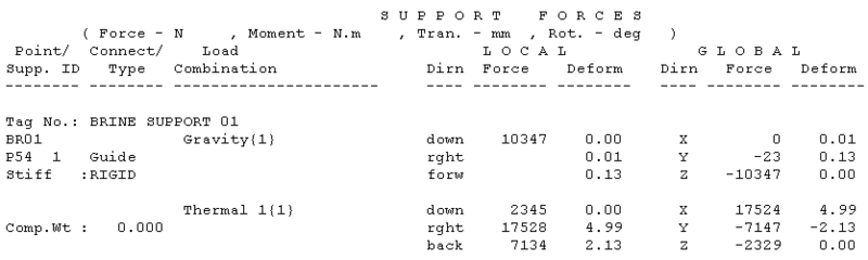

BI,
Found out that if the constraint is designated by using a GUIDE then the direction of the restraint is governed by the slope of the pipe since it will always be perpendicular to the pipe.
RE: AUTOPIPE QUESTION
OK, so the support engineer is left to convert that pipe-perpendicular reaction to global vertical and horizontal forces on his not-sloped beam all by himself.
Tnanks.
"He's declaring war on the planet itself."- Vicente Fox

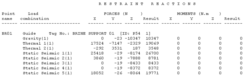

Autopipe reports both global and local results. The support report is local and global. The restraints report is global. The support/shoe designer would use the supports report and the structure/foundation designer would use the restraints report.
Yes! I thought it would be something like that.
