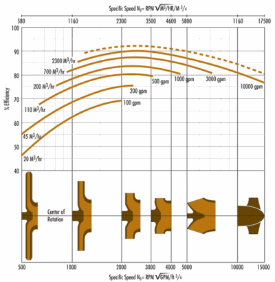

I think the article suggests centrifugal as guideline. It states for instance that PD are to be avoided due to their pulsative effects on hydrocyclones. If you want to dig dipper into centrifugals, then my suggestion was to translate the guidelines into a selection chart.
I tried to post a diagram that I fished out of the internet to identify some trends.
Based on the Shell guidelines, it seems that we are looking at pumps with a flowrates in the range of roughly 200 gpm, most likely multistage pumps are expected (e.g. Worthington WD pumps). Clearly there are multifactor entering into play and this should be a case by case problem - but as far as typical trends are concerned this would me my ball park guess.
