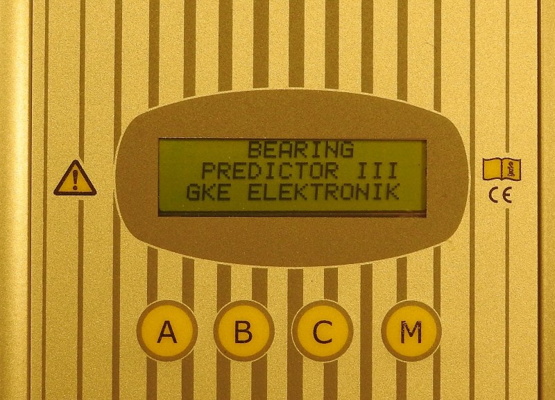

Needs: 4 rows 16 or 20 characters. No graphics. Light-emitting or reflective with background light. Light on/off/intensity selectable. Colour OK but not necessary. Mature technology.
Constraints: Shall work from -20C to around +50C. Lowest possible (<10 mA) power consumption. Life better than 50 000 h. Cost lower than USD 30 in 100+ quantity.
I have quite a few candidates, but may have missed a few. Suggestions?

That is what I have, more or less. But the backlight draws more current than I like. Otherwise, it is very much what I am looking for. The one I use is hard to read in dark corners behind machines. But four AA batteries go flat too quickly for my liking. So, something like that - but lower draw. That would be something for the children to have.

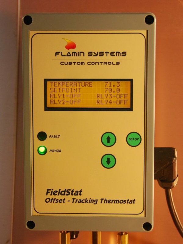

I have this one now:

If you're really trying to save power then usually you kill the backlight unless someone has pressed a button. You add that the buttons do nothing at all except turn the backlight on on the first button pushed. Leave the backlight on for whatever time period makes sense for that product and then have it time-off after the last press. If the whole thing is in a black hole consider having the backlight come on for 1 second every 10 or 20 so someone knows there's a display available.

What kind of backlight? You could replace with EL backlight, which is way lower current draw than even LED. Additionally, EL is already uniform illumination, so nothing else needs to be done. Timex had a version called IndiGlo for their watches.

Thanks, IR and Smoked! That is the kind of input I needed. Never thought about electroluminiscence. Can't even spell it right, I guess.
And that Light On on first Keypress is something I needed to be told. Thanks a lot!
