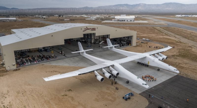

Very impressive! Does anybody know which CAD did they use? Was it NX, CATIA, or something else?

I wonder why they have (apparently) two flight decks ? There have been several airplanes with twin fuselages, but typically only one flight deck.
RE: Which CAD was used to design Stratolaunch?
The flight deck on the left is empty and unpressurized. Future options I guess. (There's a link on Drudge today for the whole story.) I'm not in aerospace but it is my understanding that Catia is the preferred tool for aerospace design.

The lack of elegance of curvature on the fuselage indicates SolidWorks.

It's got this weird look of some sort of advanced-beginner training model. Not speaking so much to the capabilities of SW so much as the type of design that often emanates from middle-of-the-road users venturing into more daring territory for the first time.
Fuselage looks like a pair of scaled-up Cessna 172s with B-1 noses scabbed on. "Corners" of rear half of fuselage are not C2 continuous. Flat side walls surrender a lot of structural integrity inherent with a more cylindrical/conical shape.

The space between the fuselages is for payload and I had assumed the flat sides were deliberate to maximise that space. . . . Or perhaps they were designed in Solidworks.

I find it hard to believe that the shape is limited by the capabilities of the CAD tool. Sure SW is seen as CATIA-lite. I suspect that the licence fee is lower and the capabilities similar. Someone starting out now has more options that 10 or 20 years ago, and isn't married to the big CAEs (CATIA, PATRAN, NASTRAN).
I think the shape is the shape they want, from CFD. Flat sides improve the wing end plate effect, I doubt the the payload has much impact on this design decision. Those enormous MLG bogies must be murder to retract (into a sensible shape).
As for the second cockpit ... maybe that's reserved for payload operating crew ?
The round shape of most higher altitude transport aircraft come from the fact that they are basically flying pressure vessels built for human "cargo". The payload for this aircraft is all external (between the fuselages). I would bet that the sections with flat walls are not pressurized (thus not intended for humans), so their construction could be simple rectangles. I would guess that the only areas intended for possible human occupancy are the cylindrical shaped front sections of the fuselages. The article I read said that the crew is in the right flight deck. The left one is vacant and unpressurized. The left one was probably designed that way for aerodynamic symmetry and for potential later occupancy.

You guys must be joking. Any CAD package I know of, in sufficiently incompetent hands, could have generated that fuselage profile.
It looks like one continuous nasty loft, from bow to stern done by some junior-designer hired 1 week after the into course.
The fwd fuse corner fillet and the wing "fairing" blend look terrible. Maybe there was some need to compromise, for unseen internal issues.
The tail will have interference drag at the root. More than if it looked more like the marketing promo models.
Reality probably bit somebody on the a**, and this is just what they settled for.

Regarding the flat sides. They need a big ground clearance for the payload, therefore the height of the fuselage is given. But it is not worthy to make its width similar, thus getting closer to the cylindrical cross-sections. That would mean extra material and weight for nothing in return. Having said that, I am not an aerospace engineer.

The fuse shape isn't that dissimilar to the B52 (except where they sweep it up to lift the wing) which makes sense as it is also is largely unpressurized.
The critical horizontal tailplane loads would likely be quite asymmetrical already, given those three engines appear to be very closely spaced by airliner standards. Will be interesting to see how much tail shake it has during a full power ground run.
