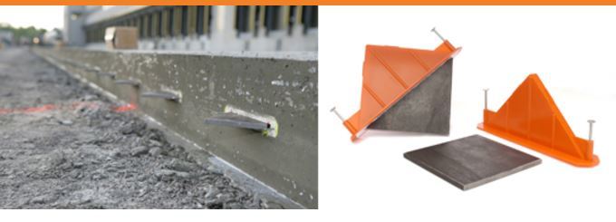

As far as I've been able to tell, a north american dowel meets these criterion:
1) Cylindrical in shape with a length well in excess of its diameter.
2) Crosses some kind of boundary like a cold joint.
This is why we communicate with little pictures. Even #1 is negotiable per the dowels shown below.
RE: is it incorrect to call pier/pedestal reinforcement of spread footing as vertical dowel?
Yes, I think #1 is clearly not inclusive. Not only the plate dowels shown in the pictures, but relatively common square dowels violate that definition.
