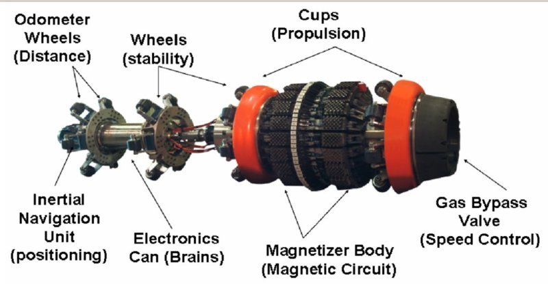

Internal inspection is intelligent pigs - look them up
One of these bad boys

No LP required IMO. It is well known in the industry that corrosion is by far the #1 cause of all leaks and third party activities cause the most property damage and loss of life.
1.) Pipelines are already installing the components necessary to use the inspection pigs LI pictured above in all new regulated pipelines and over the next 20 years or so for old pipelines.

Combine it with a well executed internal inspection system every 5 years and then doing something about the things it finds and you're a long way towards your goal of no leaks and no harm the environment.
A well designed, well installed and well inspected pipeline is the safest and cheapest means of transporting fluids long distances. The key is the "well" bit.

RE: Leakproof Pipeline
Pretty good. One or two things I would change, but pretty minor.
I find it astonishing it took until 1994 for new pipelines to be piggable as part of the regulations and that gas pipelines has liquid in them(!!)
"I had no idea of what a pig was '(sheltered life); I'd never heard the term."
That's ok, not many do. Just remember it's a name. If anyone EVER tries to tell you it stands for Pipeline Inspection Guage then immediately discount any other pipeline related material to come out of them.
Some environmental engineer somewhere decided to include it in an ESIA or non technical summary and it's just grown a life of its own since then. It doesn't, it never has and it never will.
/rant over

Pig comes from the tangled ball of chickenwire that they used back in the day. It would squeel it's way down the pipeline.
The origin is not clear - some say it was when they sent actual pigs to eat their way out of medieval sewers, most refer to the squalling of rubber or leather cups and similar "back in the day".
You need to call them "scrapers" in the Middle East just in case anyone takes offence....
IR: Not given the time period... even early in the just passed century.
Just finished that article on pigz and had no idea there were so many different types...

Yeh, I was pretty sceptical as well, but maybe for a small blockage.... pig
The squealing of rubber or leather, especially in gas or air is much more likely.
The other thing about it not being a name but an acronym (it isn't) is that the vast majority of pigs don't inspect anything - they just clean or try and separate.
For separation of products in a pipeline they actually don't do very much at all. I used to work at a multi-product pipeline company who did tests between inserting spheres and pigs to separate batches and no sphere or pig.
They found it made no difference and actually stirred up deposits and basically stopped using them for that purpose. Much of the interface was actually the time taken to open one valve and close the other in the inlet manifold and the mixing of product in the manifold.
