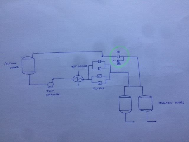

I have a question regarding the design of a restriction orifice in centrifugal pump operation. The function of the RO is to have a continuous minimum flow during operation. In plant designs I've seen, they typically place the orifice in a line going back directly from the pump discharge to the suction vessel. In our system, the line going back to the suction vessel is located much more downstream. The branch is located at the end of the main process line and this main process line consists of piping, fittings (bends, manual valves, check valves) a heat exchanger and filters.
To determine the bore diameter, I need the minimum pump flow (from vendor) and pressure drop. I know the minimum pump flow (16 gpm, the flow through the main process line is 100 gpm) but I'm not sure of how to determine the pressure drop. My way of working is to look at the total differential head at minimum flow (from pump curve) and calculate the suction head. The sum of these two is equal to the discharge head. If I calculate the frictional losses (due to fittings, heat exchanger and filter) and static head, I know which pressure drop the RO needs because the sum of these is the discharge head.

Can you sketch out a flow diagram for us so it is clear in our minds what you are trying to do.

Agree with the concern regarding the uncertainty of the dp across the filters. The branch tee (leading to this RO) should be located upstream of this filter and any other devices that may show variable dp at a fixed flow of 16gpm.

@ashtree: I drew a simple PFD of the process (RO marked in green), I hope this helps.
RE: Determine pressure drop of RO in minimum recirculation line
#3 No, it is a bad idea. Dirty filters, mis-valving, etc. will dead-head the pump. Too many opportunities for error, especially if not fully automated.

I'm not a fan of continuous flow bypasses. They are a constant power loss and to me a rather brutal way of maintaining flow. Have you thought about an ARV. That way you don't have to worry about pressure drop as it varies on flow. If you add up the lost energy it might make commercial sense to use it.
If you want to use an RO here then you will need to look at worst case pressure drop. The min flow figure is quite low so I wouldn't want it to be much lower.
It's in the wrong place though.
You only need to calculate pressure drop at 16 gpm.

Thank you for the replies. the use of an ARV is probably too late as we're in a late project phase but I'll definitely address it. Based on your replies, I think the best way for now is too use the pressure drop of a dirty filterelement (an alarm is generated at a certain filter pressure drop so I can use this value) to calculate the pressure drop needed by the RO. The flow through the RO will be greater initially but this is less of an issue than dead-heading the pump.

Is this a dirty operation which is designed with four filters?
IMHO, at the first opportunity as the system is in service, the RO bypass line can be relocated close to the pump discharge, i.e. the upstream of the heat exchanger. So, it can safely protect the pump.
@mk3223: The operation is not dirty, the fluid is water in which any type of contamination is not allowed. I totally agree that upstream of the heat exchanger is a better location but the intention of the design is to have some kind of recirculation through the whole system instead of just downstream of pump discharge.

I'm curious as to why you show an actuated valve around the RO? Why?
Can you add an actuated valve on the RO line and open & close it based on flow?
@LittleInch: I made a mistake here, thanks for mentioning it. The actuator shouldn't be there as it is just a manual globe valve to bypass the RO.

The system can work safely once the operation procedure and training are provided properly.
But, the pump could be vulnerable if the flow is blocked in the heat exchanger or filters. The long circulation piping route can protect the pump in expense of the energy and extra piping material.

The problem I see with your diagram is that the exchanger in the line will either heat up the inlet tank or cool it, not sure the duty direction. Unless the fluid is terribly full of junk to be filtered, put the min flow RO just around the pump(s).
