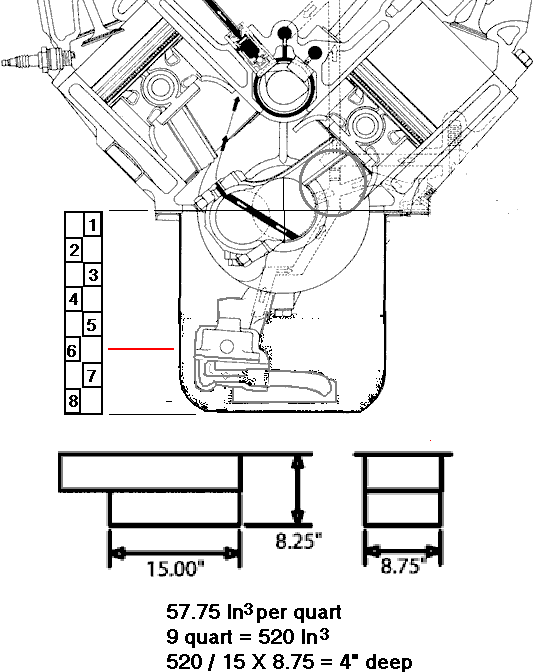

On a car enthusiast forum, a recent discussion on the dipstick indication got me to thinking about “How is the sump level designed”. I had no luck with Google and from discussions on other forums it appears there is a lot of myth intermixed with reasoning.
For example, my illustration shows where someone measured to their dipstick FULL mark (with the pan off) and was 5.5” below the crank centerline. Thus with that as FULL, the shown advertised 9 quart pan would only need less than 5.5 quarts to show full.
So does anyone know if there is any design criteria the industry uses to set FULL on the dipstick.

Designers select an oil volume for the engine, give the lubrication, cooling, and drain back time, today this is usually 4-5qt.
Then they select an oil pan depth based on space available, crank clearance, and some amount of slosh freeboard.
The fact that the gross capacity of the pan is 9qt and it reads full at 5.5 sounds perfectly sensible.

If the vehicle goes around corners or accelerates with vigor, there may be a horizontal baffle between crank and static oil level, sometimes with trapdoors.
The one thing you want to avoid is having something moving at crank speed contact the oil pool.
... except for engines without oil pumps, which may have 'dippers' on the rod caps, or other oddities intended to splash oil where it needs to go.
