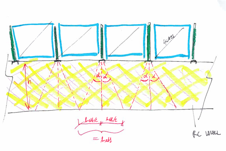

One more question...
I need to determine effective width of a RC wall at the base (beff). I need this so I can control if existing reinforcement at the base is sufficient. What should be taken for ALPHA? I was thinking about 30o
RE: adding a fence on high thin RC wall
As long as the height of the wall is greater than the height of the railing, I would treat the effective width as the width of the railing spacing. If the wall is going to fail because someone leans on the rail... you have other more serious problems.
