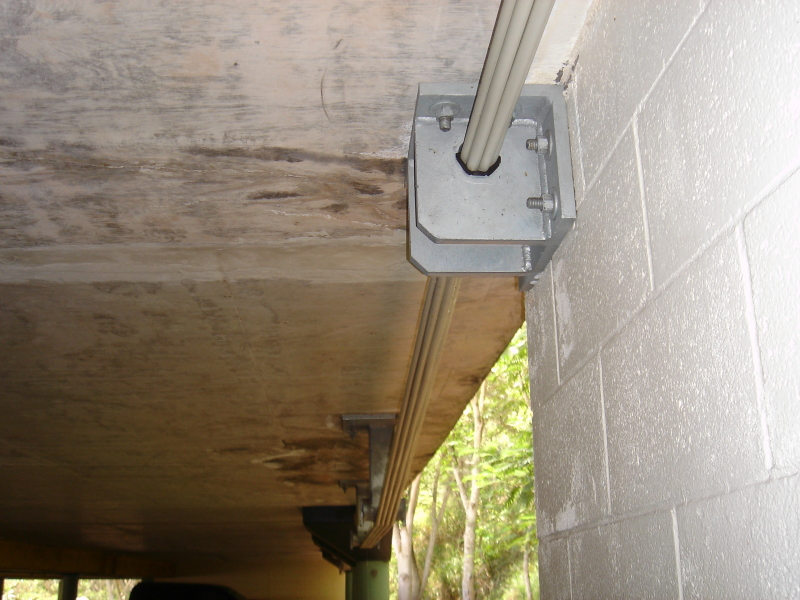

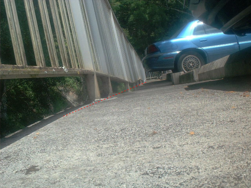

A significant number of PT structures that I have been involved that were constructed in the late 60's/early 70's have had excessive cracking and deflection problems, with the majority of those being 2-way banded/uniform slabs that had too thinner slabs.

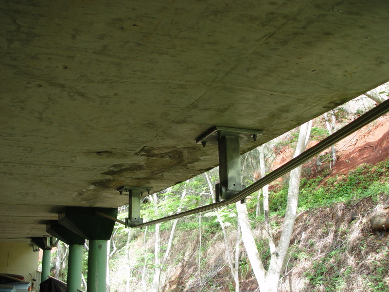

One notable project from 2003, was a roof level 2-way slab parking structure from the early 70's that 'lost' 50% of its banded tendons parallel with a slab edge (due to corrosion) with resulting midspan defections of 4"+ for a 5-½" thick slab with 25.5' spans:
Slab was emergency shored, then we did some temporary external PT (designed with RAPT software) consisting of 4 tendons with galvanized steel deviators, harped:
It was a temporary fix to 'buy' some time (12 months) for the owner to raise the funds to eventually demolish the roof deck and replace.

The garage we are most involved with currently is one way non-prestressed slab supported on post-tensioned beams, although in the past we have also investigated 2-way flat slab system. Was the 25.5 feet clear span or centre-to-centre span? 5.5" thick p.t. slab (span/thickness = 55±) seems way too much, if the span is the clear span. The photos that you included are very interesting and look like a neat solution, even though temporary.
I note that the tendons are not encased. I suppose that is ok for a 12 month maximum period, and the owner does not significantly extend the 12 months (as I find can happen when we tell an owner that a fix has a given temporary life). If one of those unencapsulated tendons should eventually fail due to corrosion or any other reason, it would be a significant public safety hazard, but I expect that you considered that. I suppose the lack of fire protection could also be justified on the basis that it is a temporary emergency fix.
The deviators look neat and well thought out. Would you have a photo of the anchorage for the ends of the tendons?
25.5' was centerline span. 12" dia. circular columns with 4' square inverted truncated pyramid capitals. Vibration was so excessive immediately after construction that W16 steel beams were attached (hung) from the underside of slab along both column line directions to reduce effects.

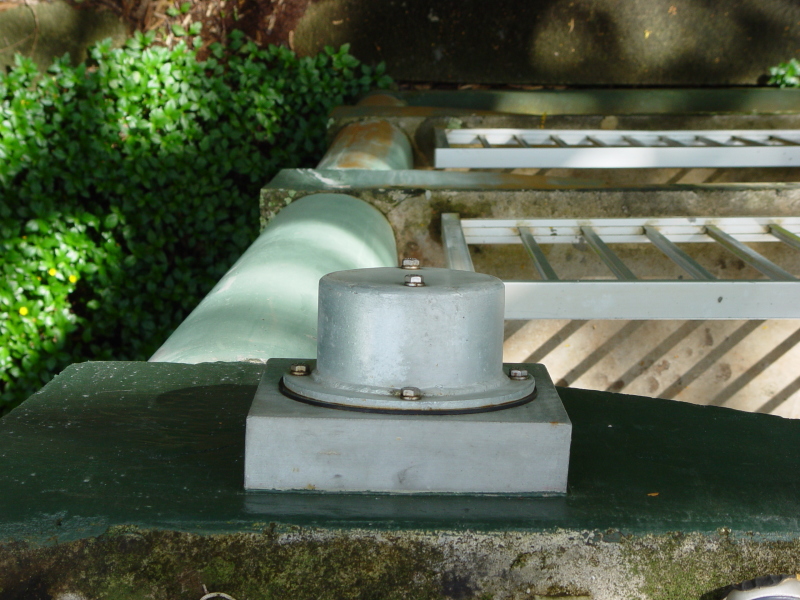

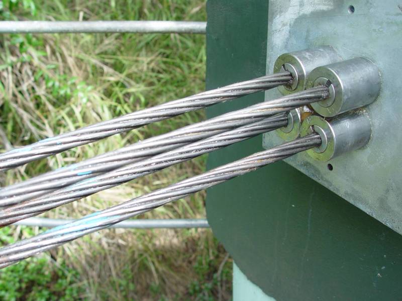

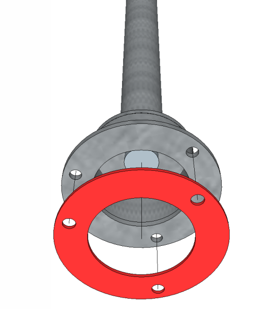

The four (4) tendons were double live-end stressed (300+ feet long structure), terminated with 2" thick x 10" square custom galv bearing plate with barrel chucks and wedges:
Upon completion of the stressing, the tails were cut from one-end and a galvanized top-hat cap, grease filled, with rubber gasket, was stainless steel screw attached to the bearing plate. Similar to this thread back in April 2017 Link. Bearing plate was PU caulked around perimeter.
One of the live-ends was left with 4' long tails and the top-hat was modified to incorporate an extended galv tube with end cap to accommodate and protect the tails, so that when it came time to demolish the roof structure the external PT tendons could be de-stressed safely with ease, simply unbolt the extended end cap, and hydraulically de-stress the tendons, in multiple strokes. Somewhat like this sketch:

Against what was the end plate placed? Was there a wall each end?
Did the intumescent coating have any moisture barrier properties to prevent condensation on the strand and corrosion?
Have you ever used an intumescent coating on strands where an inspection opening was chipped into the slab soffit and a removable cover plate installed (to allow future inspection on the strands)?
No end/corner walls, just an existing corner column condition made up of 12" circular column and existing cut-off truncated pyramid capital - we cored horizontal drill 2" diameter holes thru caps, with obvert of hole flush with underside of slab. End details like this scaled sketch:
The depth of the existing capital was substantial, but we did introduce an end eccentricity to accommodate the anchorage location.
There were a few parallel and perpendicular exterior walls and we made up custom steel deviators to take care of the harped tendon forces:
The perpendicular wall details was simply a CMU through-hole with steel deviator pipe to reduce masonry bearing stresses.
The intumescent coating is integral with the strand/sheath system, and has the appearance and touch of a typical PT sheath (HDPE or Polypropylene), albeit a little thinner, and not as pliable. During the manufacture of the unbonded tendon (after the 7-wire strand manufacturing process), the bare strand goes through a grease bath, then immediately following, molten HDPE pellets are applied to create a thin HDPE sheath, that is water cooled, then a proprietary intumescent, woven-cloth reinforced FR material is applied immediately following, that bonds to the sheath, so their is no air space between the sheath and the FR, then an outer protective sheath is bonded to that. I think that is how is it manufactured - been more than 10 years since we last used the product.
On another project, FR was addressed by metal lathe and vermiculite plaster - awful product to hand apply, and the finished product looks awful too.
Have also used larger diameter continuous HDPE pipe/duct with tendons placed inside, then cement grouted the pipe. Looks way better than a plastered FR tendon, but in reality you don't actually get the FR along the full length especially at the deviation points where the tendon bears tight to the pipe/duct so no 'cementitious' cover here.

To Ingenuity - your detailed description and elegant sketch makes things very clear. Looks like a very well thought out and detailed job. Your "Ingenuity" name is well deserved. You should have won an award for this job, but I guess success is its own reward. Thanks very much.
