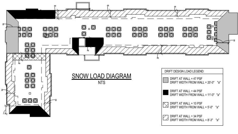

Please see attached...
A steel joist manufacturer is asking, "To confirm that all the loading in loading diagram for 32LHSP-63 is concurrent and that standard load combinations apply"
If loading is concurrent, then all loads in diagram could occur, 100%, "concurrently" or simultaneously (at the same time).
If standard load combinations apply, then a 0.75 reduction factor can apply to "L" and "S" in one combination. In another combination, either "L" or "S" can be omitted altogether.
I don't see one ASD (is there anything else?) load combination that requires both "L" and "S", 100%, concurrently.
(Sorry for being so conservative, but, isn't this part of our unwritten law? - A "What if?" scenario "COULD" happen; And when it does, I don't consider ASCE load combinations holding any weight in the courtrooom. MY bottom line is, for safety sake, I don't WANT a failure to occur.)
Therefore, isn't the manufacturer inquiry a contradiction?
Any suggestions on how to reply to this inquiry "To confirm..."?

Like the folks above, I think it's a reasonable question to ask.
Seems to me like there are two different questions posed by the manufacturer..
1) Are all loads applied concurrently?
I believe that this has nothing to do with load combinations and everything to do with the 4 different "load diagrams" present on your diagram... I think it's a little confusing...
You have top chord dead load listed in three different places. Are these meant to be additive? Or are they taken one at a time?
Similarly, the snow load is listed in three different places. Are these additive? 0.14 KLF is listed in two different places. Maybe a plan view would clarify this, but it strikes me as odd. Also, one of the "load diagrams" shows a drift that flattens out and another shows a uniform snow load. Is the uniform load Pf, to be combined with the drift or Pm, treated independently. If it is Pf, where is Pm? (Assuming ASCE 7-10)
I think they're asking if they combine each of these 4 diagrams into one master diagram, or if each represents one load scenario that is treated independently.
2) Do standard load combinations apply?
This seems like an after thought to me, based on their confusion about concurrency.
I absolutely believe that we can insist on an ASD or LRFD design. I recently selected a standard joist that worked fine with an LRFD design, but would need to be two sizes larger using an ASD design. If they were free to arbitrarily choose which methodology to use, I could find myself in trouble.
To clarify, I believe that you're talking about Live Load (L) and not roof Live Load (Lr), correct?
LRFD allows you to utilize 50% of the live load in many situations in which both snow and live occur (ASCE 7-10 2.3.2 exception 1).
ASD takes 75% L + 75% S (ASCE 7-10 2.4.1 combo 4)
To me, the interesting question is whether or not we can insist a joist manufacturer NOT utilize that exception (LRFD) or insist that they not utilize that 75% factor.
I would be inclined to think that we could, as long as the requirement is clearly outlined in the drawings at the time that the project is bid.

For what it's worth, please see attached (partial) Roof Framing Plan...
Quote (KootK)
Is it your intention to create your own, more conservative load cases for this project?
Yes… That WAS my original intention. However, through the effectiveness of Eng-Tips advice, I am leaning toward being “at peace” with the already established ASCE combinations. Admittedly, I still struggle with “What if?” BUT… I do NOT lose sleep!
Once20036…
- I itemize my loads when I make diagrams, so that, in the future, I can more easily account for how I derived the total(s).
- (3) top chord DL’s, from the top, are: 1. Penthouse Floor. 2. Penthouse Roof. 3. Warehouse Roof.
- (3) uniform SL’s are from the same. They are Pf. Wisconsin – (Still) ASCE 7-05.
- Partial and trap SL are drift from north side of 21’-3” long Penthouse and east side respectively.
- All loads are concurrent.
- I am specifying that standard loads apply.
- The LL applies to the Penthouse Floor which is intended to be used for storage.
- I will be specifying ASD (or LRFD) on the documents, in the future; something I have yet to practice.

- I agree… assume the DL, LL and SL are concurrent and then apply the load combos.
sticksandtriangles… Although it DOES consume more time, I like the load diagrams for the historical inevitable necessity to clarify and reanalyze, if necessary, in the future… especially for complicated situations.
