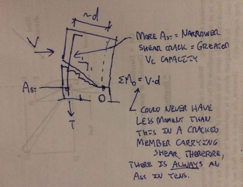

You're most welcome NTC. How about this:
1) In a member loaded in shear, there really is no such thing as zero moment. At minimum, you'll always have at least the moment equivalent to V x d (sketch below).
2) Because of #1, a shear cracked member must always have some amount of flexural tension reinforcing (Ast). Were this not so, equilibrium simply could not be satisfied (sketch below again).
3) More flexural tension reinforcing means smaller shear cracks.
4) Smaller shear cracks means higher Vc shear capacity.
Taken in aggregate, points one through four mean that there's always some Ast in a shear cracked member. That pretty much addresses your question does it not? Really, it's not possible to have cracked Vc without Ast. In that sense, kudos to the AS/Euro provisions for capturing that.

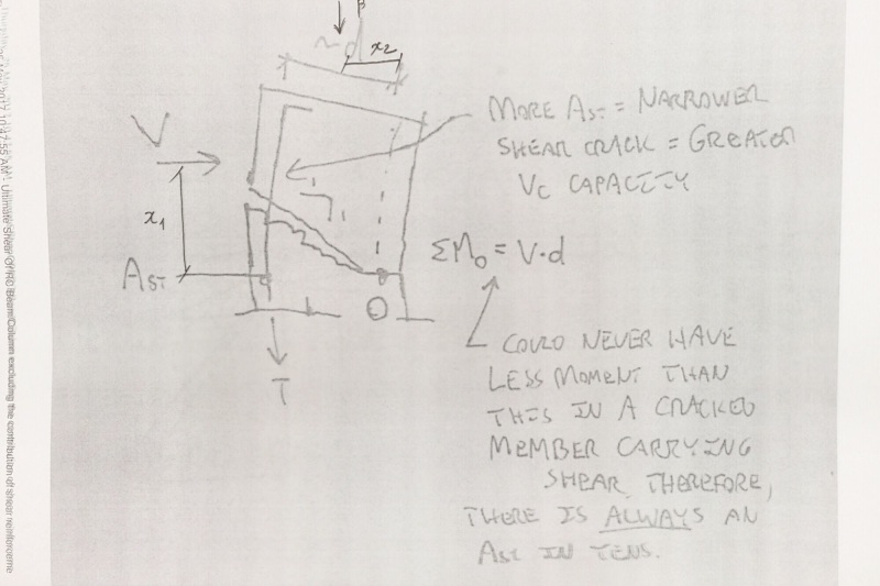

hi KootK
Thank you for the sketch, it all makes sense perfectly.
I think the lever arm should be the distance x1
instead of "d" ?
I drew on top of your sketch. My question is:
Case 1)What if there is load P acting on top of this short column
which makes all steel to be in compression, and also this load P
acting at an eccentricity causes a moment at 0 which happens to
be exactly same as moment at O caused by V.
In other words, P * x2 = V * x1 thus the sum of all moment about point 0 is zero.
Is that in that case, there is no Ast (no steel in tension)?
Case 2) Let's assume this is a bucky concrete block and there is no steel at all in it.
The block is under compression force P. and a horizontal force V
And I would like to determine if this "prestressed" block in sufficient for that shear force V
without having to have some steel rebar and/or ties in it? This certainly can happen in reality
for example, with force V being very small.
One would think that we would have to compare this force V to the Vc of this concrete block,
but the equation for Vc , again, requires Ast, or else Vc =0. This leads to the designer having to
put some Ast in the concrete, even though it may not be necessary ?

Case 1. Realize that Ast doesn't actually have to be in tension to count. It merely has to be available for use in tension should the shear crack tend to open up.
Case 2. You're deacribing a plain concrete scenario. I would assume that your code has a different provision for the shear strength of unreinforced members (steve's post).

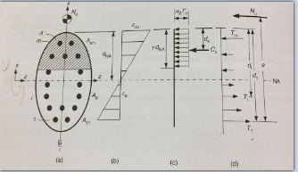

Rapt, if the As is distributed like in the below figure, what bars would you count for "Ast" in this case?
Correct me if I am wrong, but theoretically, based on the AS3600, I would need to determine the neutral axis for each load case, and therefore,
Ast for each load case would be different, thus Vuc.
However, determining the neutral axis is not a straightforward process. Note that the figure is showing the ultimate limit state,
where the strain in concrete has reached its ultimate strain (0.003). But under an arbitrary service load case, the forces (M* V*) may not cause the
concrete to reach that state yet.
What would you use for As in this case, practically ? Or any advice for designers in this case, and in case of circular columns ?

I think the Canadian code actually defines it as the reinforcement in the tension half of the section (I would take this as the more tensile half), so in this case probably the bottom 7 bars. The next 2 bars above them would appear to be on the centreline so are doubtful!

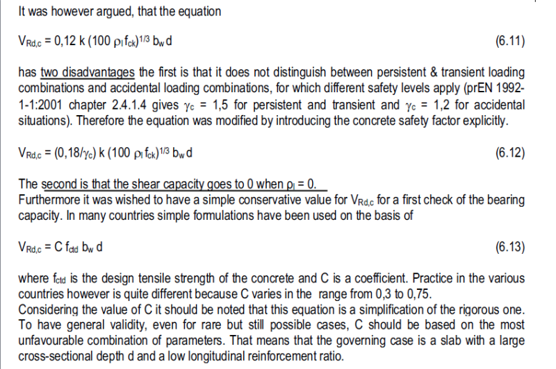

The Eurocode 2 provision has similar form which has a form of Ast to the power 1/3.
I have found a commentary to the EC2, which, interestingly, discusses the same topic.
It states that the formula has 2 main advantages. The first being that it does not distinguish what type of
loading combinations being applied thus difficult to determine the according safety factor. The second is that the shear capacity goes to 0 when Ast = 0.
The wish for a simple , conservative value for Vuc leads to the formula: Vuc = C * flexural strength of concrete * bw * d, and the coefficient C varies between 0.3 and 0.75.
For the most conservative case, C = 0.3, and says, flexural strength = 0.6 *SQTR(fc)
Vuc = 0.17 SQRT(fc) which is exactly the same as provided in the simplified method of ACI code.
