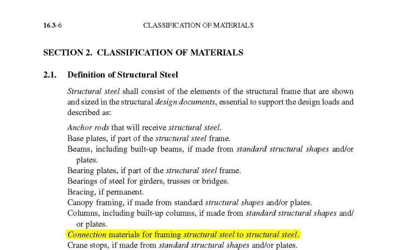

This is a "Rule of Thumb" I learned when estimating for a steel fabricator several years ago.
Sounds like simple and reasonable, common-sense to me.
Is this an unwritten rule or is this actually written somewhere in the depths of AISC or other?
Although I cannot believe the general contractor is actually inquiring, I'd rather have valid support of my "two-cent's" before I offer it, which may become an offering in a dispute.
Opinions? Documentation? Reference? Other?
Thank you!
RE: You Furnish The Steel, You Furnish The Fastener
Section 2.1 of the AISC code of standard practice.
It goes on in section 2.2 to further define what is not considered structural steel.

JStephen... In the commentary of AISC 13th, 16.3-6, of what sbisteel provided, it states, "The fabricator 'normally' fabricates that items listed in Section 2.1." I interpret this to mean that the "Connection materials for framing Structural Steel to Structural Steel" are to be considered a "Code of Standard Practice" of what the fabricator would furnish / provide.

What do the contract documents state? The revised section is 7.8.3 AISC 303-10 or 16. When erection is not performed by the fabricator, the fabricator shall furnish: bolts, nuts, washers, shims, backing and run-off
