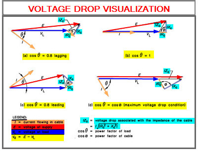

The resistive voltage drop that occurs due to cable resistance is IR Cos (phi) Where Phi is cable impedance angle and the reactance voltage drop that occurs due to the cable reactance is IX cos (phi). My question is why this phi is excluded in the voltage drop equation instead only load power factor angle(theta) is considered. Also, this phi (cable impedance angle) is independent of load.
Does not including cable impedance angle in the voltage drop calculation means it is less accurate?
I'm not questioning the well-established equation but it is rather my inability to understand why only load power factor (theta) is considered and why not also phi?

Cable impedance angle does not need to be considered because the cable R and X are included. R and X determine the cable impedance angle.
RE: Voltage drop Equation
Charz,
In my opinion, the associated angles of the power factor of the load and the power factor of the cable are taking in consideration for the voltage drop calculation as follow:
1) The power factor of the load drive the angle of the current with respect voltage at the load.
2) The Voltage drop is also equal to the cable resistive voltage drop (same direction as the current) plus the voltage drop of the cable inductance (90o with respect to the current).
Hope this help.

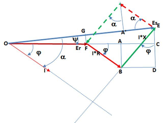

What it is odd in IEEE 141/1993 formula it is the fact we need to know Es and cos(fi).
Actually you may know Es and cos(alpha)[a] or Er and cos(fi)[ [of the actual load].
In case you know Es and cos(alpha) then:
Er^2=OG^2+FG^2
OG=Es-AE-AG
AE=I*R*cos(a); AG=I*X*sin(a)
FG=I*X*cos(a)-I*R*sin(a)
Er^2=[Es-I*R*cos(a)-I*X*sin(a)]^2+[I*X*cos(a)-I*R*sin(a)]^2
Er=sqrt([Es-I*R*cos(a)-I*X*sin(a)]^2+[I*X*cos(a)-I*R*sin(a)]^2) and VD=Es-Er.
VD=Es-sqrt([Es-I*R*cos(a)-I*X*sin(a)]^2+[I*X*cos(a)-I*R*sin(a)]^2)
In case you know Er and cos(fi) then:
Es=sqrt{[Er+I*R*cos(fi)+I*X*sin(fi)]^2+[I*X*cos(fi)-I*R*sin(fi)]^2} and VD=Es-Er.
In order to get alpha[a] if you know Er and cos(fi) we use the formula:
a=asin((Er*sin(fi)+I*X)/Es)
We get the same VD in both cases.
