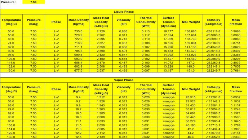

I have received info from client and we are required to find the enthalpy for the mixed flow (2 phase flow; liquid and vapor). The difficult thing for me is to find the total enthalpy for the mixed flow in kJ/kg. Client has given the heat curve in two separate phase (liquid and vapor) and enthalpy in kJ/kgmole. So now I'm having problem to find the enthalpy in kJ/kgmole. How do I convert this into combined enthalpy in kJ/kgmole.
I would really appreciate if anyone here could help me figure out this one. Attached image is what I'm referring to.

not difficult, at specified conditions (for example 50.0 C 7.5 Bar.g) you know molar enthalpy, molar weight and mass fractions for both vapor and liquid phase...

I'm not sure why the other replies got deleted. Anyway I already found what I'm looking for which is the mass enthalpy but only for each phase, liquid and vapor enthalpies now it's time to merge them to find two-phase enthalpies
