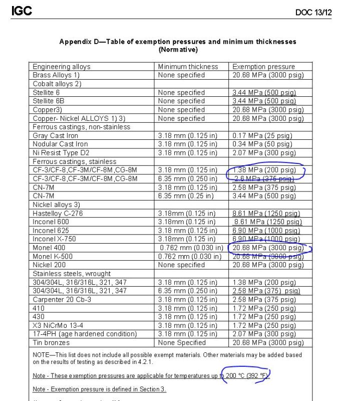

I have a 600# FL RF swing check valve in high speed oxygen service which due to scheduling issues had to have its trim (disk, lever arm, seat) changed to solid monel. The valve vendor just gave us the test documentation and they only tested the shell to 200psi and the seat leak test to 200psi. Considering this is a 600# valve and that the original stainless seat was seal welded and was replaced with solid monel seat, I feel like they need to test it to full code required pressure in order to certify the valve. They claim the valve complies with ASME B16.34 and API598 but I don't feel safe using this valve in critical oxygen service.
Your thoughts on the matter and advise will be greatly appreciated. I went over the code and can't locate a section that will give me clear answer on a rebuilt valve.
Thank you,
KJ

Hi KJ7,
Your information is not complete yet. Still missing the body material (this is related to the ASME B16.34 material selection), Is it Liquid oxygen or Gaseous Oxygen (this is related to the body material selection), what is the operating maximum temperature (related to Auto ignition and or impingement potential), what is the differential pressure and what design code and leakage rate that you've quoted?
In general, assuming the body used is also Monel400. Then you are correct it is not according to MAWP stated in ASME B16.34. at ambient temperature it should be 1,200 Psig. This is at least for the body test, Seat test might be performed at maximum DeltaP
However, also assuming that this modification done by some sort of service company (not the original manufacturer), kindly take into account two things: Oxygen (fire hazard) and Check valve leakage rate and cracking pressure. Check valve leakage rate is not necessarily Class B as per ISO 5208 and also since the trim is modified (let say Monel is heavier compare to the previous ones), then it will have some effect on cracking pressure as well among other parameter.

Below are answers to your question:
- Body material is SS A351 CF8M
- Service is Gaseous Oxygen
- Max operating temperature Ambient 30 degC
- Max operating pressure 860 psig
- Differential pressure across the valve 15 psi
- Leakage rate requirements None
- The valve is a flow preventer
- The valve modification is done by service company and they claim the valve is compliant with ASME B16.34 , API 598, API 594
My main concern is that the valve was machined in order to replace the seal welded seat with solid monel seat (the valve shell was affected by the grinding of the weld and rewilding). I don’t really feel comfortable with 200 psi hydro test. In my opinion the valve shall be retested to full pressure (as a new valve would). I was hoping to find a code reference that will back me up instead of just “feeling uncomfortable” but can’t seem to locate one.
Your opinion on the matter is appreciated.
Thank you,
KJ

Thanks for the additional information. Your service company is just being conservative with respect to EIGA or any other empirical data. In Europe we have EIGA, in US they have WHA International, not sure about other countries. And there is no single standard to cover your concern. Oxygen clean have their own standard ASTM G127-15; mechanical impact test and aging test resistance ISO 21010; ASTM G114, etc.
And once all of those standards complied, there is no assurance that it will not be ignited or even during its lifetime will ever be ignited. For that purpose you need to do what Oxygen people name OHFRA (Oxygen Hazard & Fire Risk Analysis), and even this is subjective assessment. And of course there will be price and design consequences.

Why did your service company only dare to do up to 200 degC. Basically two things:
a. Your operating paramater is 30 degC, so it will never reach 200 degC
b EIGA summary over promoted ignition. Courtesy of EIGA and not to be generalized
In summary your Monel trim is more or less ideal for this application. But your body material have a possibility to be (promoted) ignited shall operated at 200 Psig and 200 degC (see bottom note). But even this is 1 out of several promoted ignition attempted in the lab. So the likelihood is small but possible.
In regards with API quality, maybe others can correct me, I understand that there is Q1 or sort of monogram certification for manufacturer. And for testing company it can be also API598 certified, meaning that their test bench including booster pump is audited. But I am not quite certain that service company can claim that they are 16.34 compliance.
My personal comment (I am Level 4 Oxygen Inspector and have a Plant that is running at 83 barg and 400 degC most of them full Monel) are:
a. Having "not so clean" hydro test as final test is not convenient. Oxygen application shall be clean, so I would recommend to do re-cleaning and further finalized with Helium either high or low pressure testing
b. To do body test at 860 Psig or higher (1,43 MAWP??) to ensure that it is still comply with PED. This can be performed with or without valve internal. This shall be done with Helium or Nitrogen (what could go wrong bigsmile
c. Seat test can be perform at 15 Psig as per your DP or even 200 Psig
If for some reason you loose the debate, is it ok to accept it as current? Do final check yourself using black light and check the leakage rate at 200 Psig (if leakage rate acceptable process wise). If it is clean and relatively tight. Yes, I would say it is ok.
Again, good luck. This is always a challenge for even the best service company or manufacturer.
