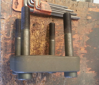

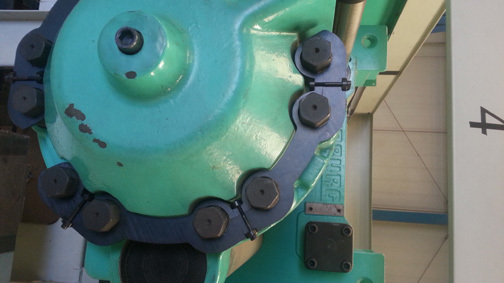

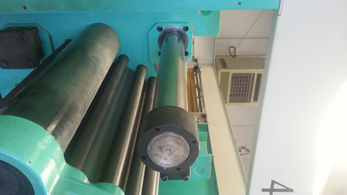

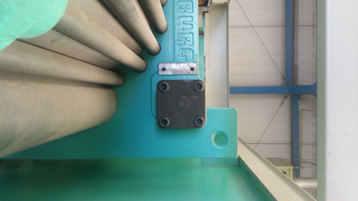

Here are some photos of a 200t clamp injection moulding machine tie bar arrangement. As it happens, we have one out to get a large tool in.
The majority of tie bar breakages are due to incorrect/uneven tensioning. In 25 years in this business I have never seen one break, but have heard of instances.
On the pics below, the black collar on the tie bar end has been marked by the manufacturer to get the same tension as designed and as built. (The tie bar has to be heated to enable getting the correct pre-tension on re-assembly)
Note the pics have rotated 90 clockwise somehow - after spending half hour on Photoshop getting them correct orientation!
Tie bar clamp in situ:
Tie bar with clamp off and extracted:
Tie bar clamp and M20 bolts:
Safety restraint around clamp cylinder studs:
