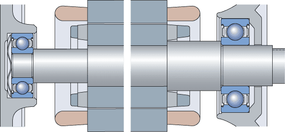

My Rotor spin to 18,000 RPM max and Shaft is on 2 deep groove ball bearings, about this size, 30-35 x 62-72 x 12-17
The issue I have at high RPM is Vibration.
What is the best practice to prevent this ?

Are the bearings preloaded axially with wavy springs or something similar?

To keep things simple I'll assume your shaft is operating at a safe margin (maybe 25%) below its critical speed. However, one thing that can affect critical speed is stiffness of the shaft bearing system, and bearing preload will usually increase shaft critical speed. Your deep groove ball bearings probably operate with some internal radial clearance and are not preloaded. So Tmoose's suggestion to use a pair of angular contact ball bearings axially preloaded with a wave spring is definitely worth considering if critical speed is a concern
Dynamic imbalance is fairly easy to resolve. You simply need to dynamically balance your rotating assembly. Take a look at ISO 1940/1 for details of the procedure. Your application sounds like it would require balancing in two planes to quality grade G6.3 or G2.5.

Application is this : Electric Motor (Stator, Rotor)
Rotor RPM go to 18,000 .
Rotor RPM come from a Dyne.
I am using 2 bearings on rotor shaft like SKF 35 x 62 x 14, C3 internal clearance.
Problem is that at high RPM, over 14,000, application/fixture start to vibrate and vibration come from bearings because if I Shim them, it is better.

Light axial preloading of deep groove ball bearings( not angular contact) is a legitimate method to improve running accuracy and improve running stability and reduce noise.
Lots of basic electric motors do that by means of a wavy spring in the end bell with the "floating" bearing.
