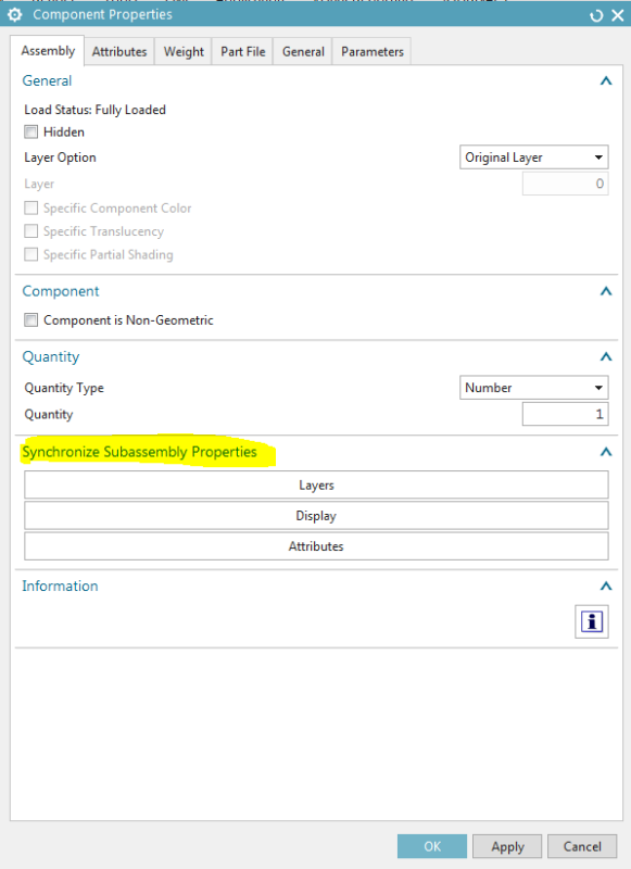

I have a subassembly with some hidden components. However, when I open the main assembly all the components are visible.
How can I inherit the subassembly display?

You need to use a Reference Set other than "Entire Part" for 'assembly2', since that is literally what it means, the ENTIRE part.

RE: One component is hidden in subassembly but visible in the main assembly
Thank you both. Both are a great help in this forum.
I understand the use of the reference set for controlling the visualization of an arrangement. It´s easy to create, to modify, etc.
However, I´m confused about how NX behaves with hidden components in a sub-assembly.
For example,
I have an assembly with some hidden components.
I create a new parent.
My reference set in this moment is "entire part", although there are some components which are hidden. We have many assemblies in this way :(
I can maintain this situation, until someone press "show all components"
In this moment I have to come back to the sub-assembly and create a new reference set for being able to control the visualization.
Initially, I was thinking that it should be something like Synchronize subassembly properties to reset hidden components.
