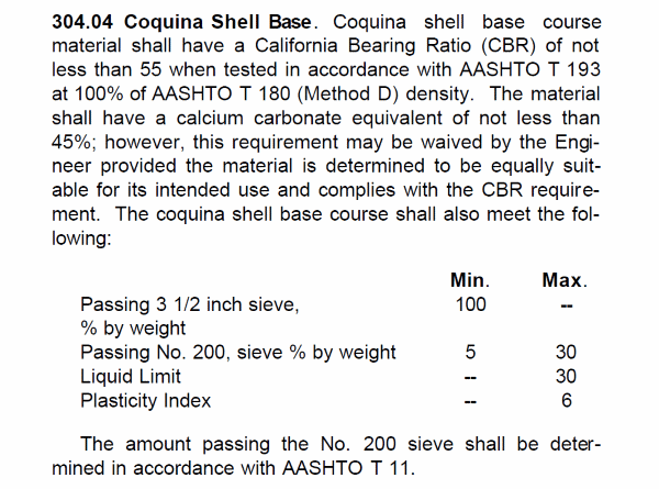

Okiryu - The material we use is defined by a South Carolina Department of Transportation specification. A version of that specification is posted below.
However what we use does NOT technically meet that specification... I'll explain. Limestone quarries sell the specified base course, but they also offer a lower cost product called "ROC" (Run Of Crusher).
To make ROC the quarry starts with the same limestone used for base course.
ROC is crushed with the same equipment that produces base course.
The difference is that ROC is what comes out to the crusher, with no tests performed on it. Without testing or guarantees, ROC is lower cost than base course, but the product is virtually identical.
Large quantities or ROC are use for roads (both paved and unpaved), foundations, building, equipment laydown areas, etc. at our electric generating stations. Soils are typically poor, water table is high, and loads are heavy. ROC is ideal for these applications.

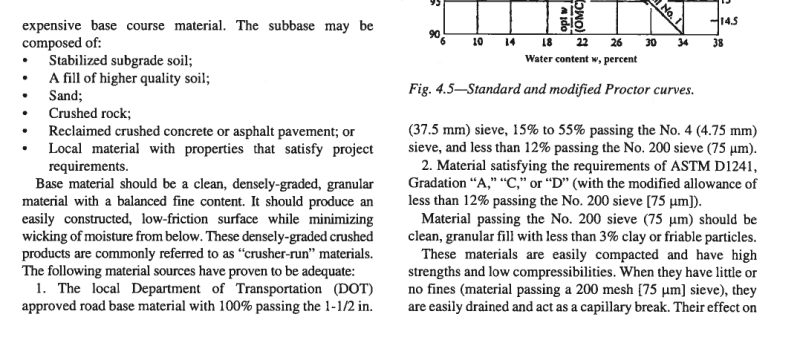

Here's what ACI-360R-10 says
